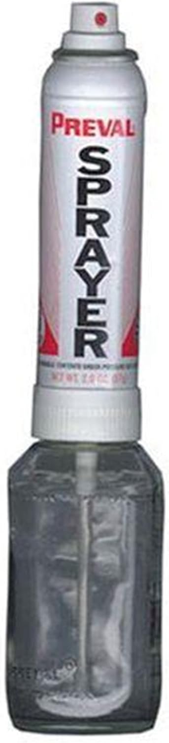

If you would like to mix your own dye & clear, you could get a couple of those Preval sprayers to do the job if your sprayer isn't working right. I've used them with Imron to touch up paint on an airplane before and they work really well.
Well, the thought had crossed my mind to use those Preval sprayers. I have used them before to shoot Dupont Centari 5000 catalyzed paint and granted, they did do the job. I know you really need to have a few extra nozzles on hand and the cannisters seem to get cold pretty quick, hampering the spray pattern. I guess this could be option #3 for the job. The question with that direction would be which clear to use; Mohawk or Colortone? I know the Colortone colorant will mix with either base stock. Oh well, more to ponder.
