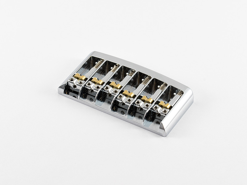

I'm getting this for my next build:
The cool thing with this is that you can adjust the spacing of the string on each bridgesaddle.
That's a nice-looking part. I've seen other designs from ABM that I've liked, too, but they don't distribute here in the states for some reason.
On top of the attractive appearance, it looks comfortable and uses a milled brass base, plus it mounts flush to the body. Makes a big difference in how lively the guitar sounds, as opposed to die cast zinc mounted on posts.
