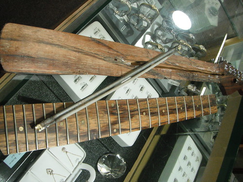

On my Karosa Goncalo Alves back/Marblewood fingerboard neck, the truss rod failed.  Big time.  The action has become way too high.  But the truss adjustment nut is nearly impossible to get to, and it won't move.
So I removed the neck, took a knife and a hammer and indelicately removed the Marblewood fretboard.  It came off a lot easier than I expected.  Then I pulled out the truss rod.
This thing looks home made.  I'm surprised it ever made any adjustment at all.  So I'll be ordering a Warmoth Double expanding truss rod soon and see if I can put this neck back together.
Here's where I'm at.  Thoughts?
Neck, Fingerboard and Truss Rod
Truss Rod Channel.  Notice how its not straight.
Truss Adjustment end.  Yes, its all boogered up.  It wouldn't move.
Butt end of the truss rod
WOW, that's jacked up....The truss rod doesn't even go the full length of the neck... :icon_scratch:
Not only that, it doesn't look like it would even work.... :dontknow:
you're probably going to have to do some surgery/fabrication to get the new rod in

That seems to be an insubstantial truss rod length; I realize they generally don't traverse the entire length of the neck, I thought they usually go at least close to the neck joint, maybe about the 14th or 16th fret.  Anyhow, I do believe a double-expanding rod would be the way to go, first off because they're just plain better, but also because that will require a larger trench (I think) so you can bore out the one they cocked up.
From a technique standpoint, excepting for a precision-milled block from StewMac or machine shop, I'd recommend gluing some sand paper (pretty rough to get through the glue, probably 120 or 180) to the work table of a table saw or similar so you can sand the entire neck surface at once to reduce the chance of making uneven spots.
As far as clamping, if this is going to be the only neck you plan performing this kind of surgery to, you may be able to get away with some (very) large rubber bands, otherwise the purpose-built fingerboard clamps from StewMac may be a good investment if you plan on getting into the neck building trade.
Wow...that is litterally two pieces of metal rod....glued together? It doesnt even look welded. I suppose wrought iron is cheaper than a truss rod  :laughing7:

I have the new truss rod.... its longer than Karosa's home-made POS truss.  And longer than the channel.
Sigh.  Time to bust out more serious tools.....  Glad I bought a jewelry store, there's some cool tools that came with it....
