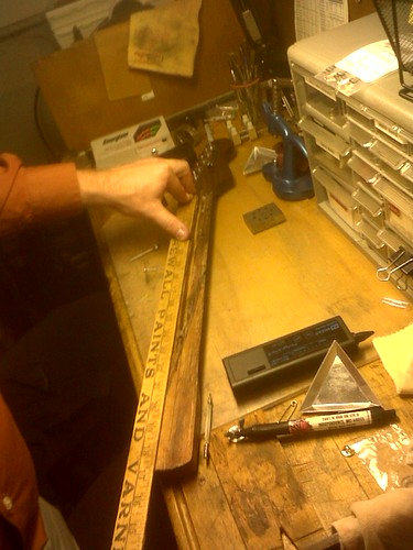

I peeled off the Marblewood fretboard and found this....
The crappiest home-made truss rod the world has ever seen.  It didn't even go the length of the neck.  It was a truss rod in name only.

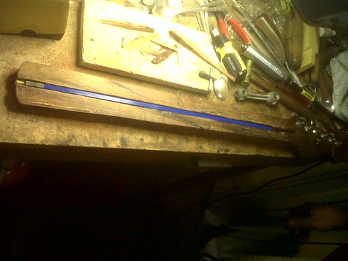

So I bought a double expanding truss rod....
But as you can see, the channel isn't long enough...

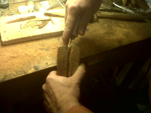

So I have this buddy, Dave, who works with me at my Jewelry store.  We had a slow day and he decided to tackle the neck while I worked on paperwork...

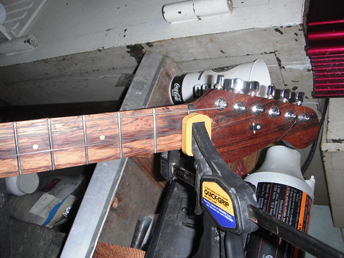

I got one pic of the clamping operation for the Nut Re-Install....

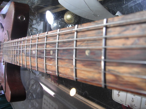

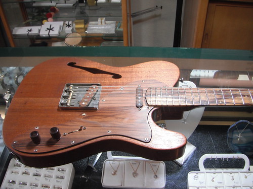

The Finished Product...
I could have done a better job gluing the fingerboard back on.  Its a little over on one side.  But its more than playable and better set up than it was before.  I can actually adjust the truss rod.  Its nice to have this guitar back up and running.  I've had this guitar for 14 years....  Well, I've had the body, the bridge plate, string ferrules, and neck plate for 14 years...  the rest of it is newer...  But this guitar is special to me, its always been loyal.

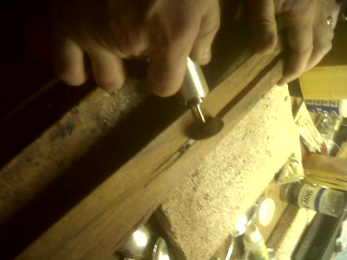

I'm glad I installed the new truss.  Big huge thanks to Dave for getting tired of waiting for me and cutting the channel for the Truss with a shaft drive, by hand.
