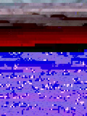

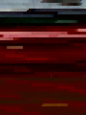

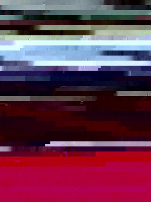

I have been super busy but finally had some time to post some pics. I love the raw feel of the neck and my only regret is I wish I was better with my camera to give the instrument visual justice. Here she is in all her glory!
Love the wood texture on back of the neck!

Looks sweet!
