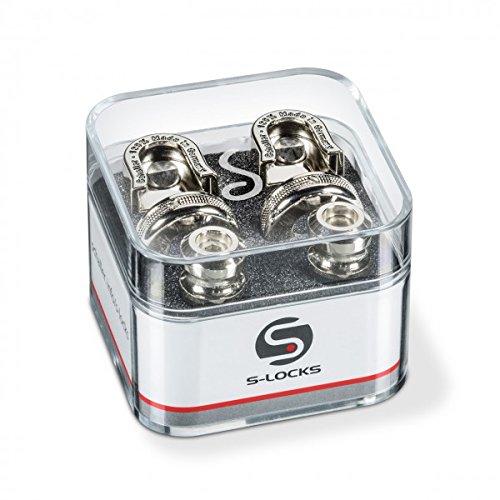

I put the new-style Schaller S Locks on my first Swamp Ash Warmoth Hybrid I did, and really liked them a lot. They've worked out really well on that guitar. So I bought a set of just the pins and screws (allows you to use the same strap for multiple guitars) to replace the stock straplock pins on my 2016/maybe 2017 MIM Lake Placid Blue Tele. I guess this guitar has an Alder body??? Anyway, even after really trying to be careful and re-tightening the Schaller supplied screw, I'm convinced I managed to strip it out some how. It is staying in it's place for now, but I have a feeling this could come back to bite me in the buttocks if not fixed soon.....

Yeah, if it were only that easy...... If I recall correctly, the Schaller screw is a metric screw with kind of an odd head to fit inside the Schaller strap button. There may be a source out there for one that would work; just ain't found it yet.....

Well, for what it's worth, I didn't "recall correctly" about the Schaller screw head. The strap button IS the head of the screw. The button and screw apparently are machined as one integral unit, it looks like.  :dontknow:
