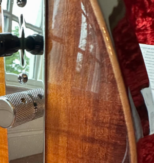

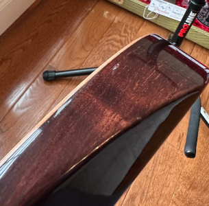

(Top has a burst, then what I believe is a masked edge, then a clear back (walnut) OR might be mahogany with a "transparent brown" back. What do you think?

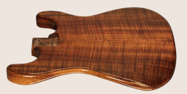

Also, If I choose "Flame maple" from the laminate top dropdown, I'm shown the image on the left. Will I actually receive what's in the image on the right, or will I have to add one to my cart separately? It's hard to tell because the preview in the builder doesn't show nearly the same thing. (See images below)
(The figuring/grain I don't want) vs. (The figuring/grain I DO want)

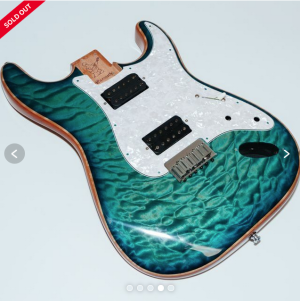

If you have a "Natural Masked binding" and "Clean Line" it looks like the attached image (using clear back). It reveals the edge of the maple top and also clear on the back. However there is still a burst painted on the front where you see the black outline on the front part of the body.
There is *always* some kind of burst sprayed when you select "Natural Masked binding", so there is a bit of a contradiction if you specify both "Clean Line" and "Natural masked binding". However there are some cases where it allows the back to be painted with a different colour, or finished in clear. I think Warmoth have reduced the number of back finish options on the builder, so maybe they need to confirm what is possible as off-menu options.
Are you specifically looking at the Brown to Clear burst finish?

Yes, I'm look to get a brown to clear burst finish on top, have a line of some sort, then the back be completely clear.
A natural masked line is an entirely different thing to a laminate line.
If you order flame maple it will look nothing like the picture on the right because that is flamed Koa, far rarer and more expensive.
It looks like ash finished in transparent brown to me, tobacco burst for the top seems more fitting than brown to clear. If you choose those, masked edges will be available.

If I choose "Flame maple" from the laminate top dropdown, I'm shown the image on the left. Will I actually receive what's in the image on the right?
View attachment 65699 View attachment 65700
I realize you're just asking about the level of the figuring, so I'll ignore the fact that these are two different species of wood, and answer thusly:
Firstly
The picture on the left is not a photo. It's an artificial representation of a what the guitar body you are ordering might look like, given all the specs you have selected. The picture on the right is an actual photograph of an actual top, under real finish. So it's always gonna look better, no matter the level of the flame.
Secondly
The images of figured maple used by our custom builders were chosen thoughtfully, to keep from "over-promising" what the final results might look like. AKA, nobody is gonna complain if their body happens to arrive looking better than what they saw when they ordered. (And what I just said is not a promise either. If you order a flame maple lam top, you'll get a flame maple lam top - in any one of its myriad forms.)
Thirdly
The term "Flame Maple" encompasses a range of patterns and looks; wide flame, tight flame, straight, curved, etc. If you are particular about the exact pattern or level of flame, you will want to choose a Unique Choice lam top for an additional charge, and add it to your cart separately. Otherwise, you'll get what you get. (Which doesn't mean it won't be nice. It just means you won't get to choose exactly what you want.)

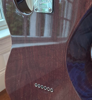

I don't think anyone has said that you should be able to tell by taking the controls or neck off. If the back was sprayed with a tint and the top wasn't then the cavities should show the wood's natural color and grain. The cavities might be shielded but the neck pocket should be untouched. It's hard to tell how grainy it is. It doesn't look like the natural color of any common core wood. A little too red to be walnut and too brown for mahogany types.
Yeah I completely agree. I'm pretty sure they've sprayed over the wood, so I'm thinking I'll do it with a transparent brown back finish. That's if "Transparent Brown (Burst-Over)" means the whole back will be brown, and not have a burst effect tapering to a clear center.
