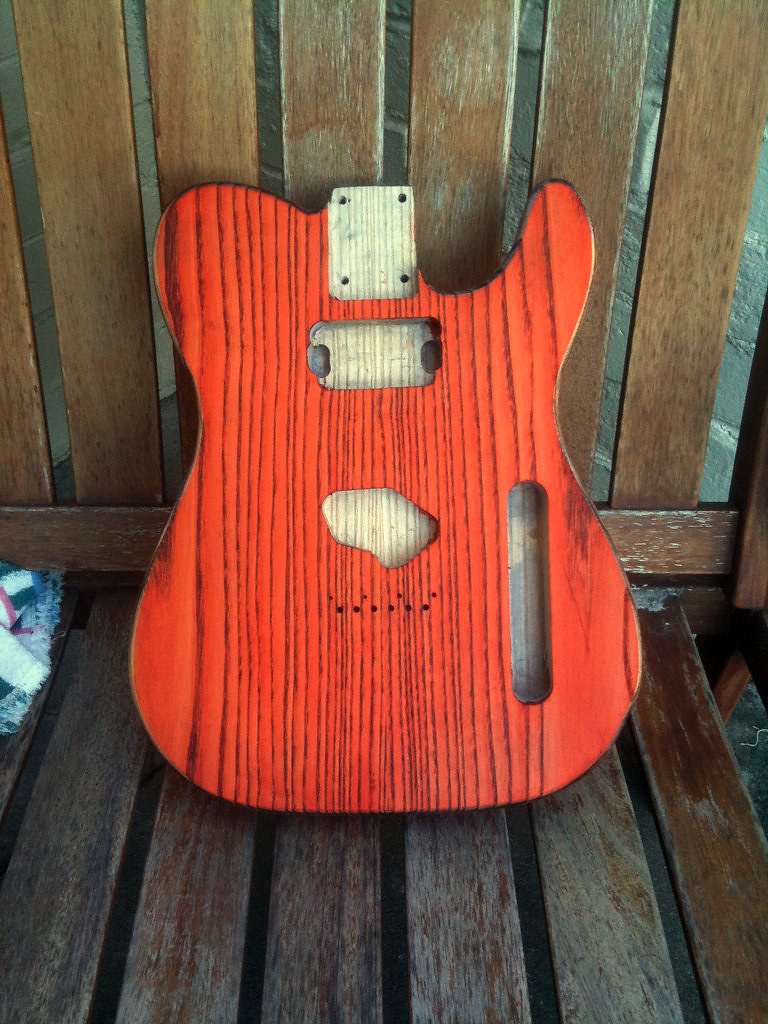

This is a General Finishes water-based orange dye on black-grain-filled ash.  Your mileage may vary, but I'm pretty happy with the result.
What grain filler did you use Bagman67?
Timbermate.  You can tint their neutral to suit your needs or buy any of the pretinted colors.  It is waterbased so cleans up easy and dries fast.  You will probably need more than one application.
