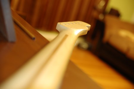

I'm obscenely busy with responsible adult things lately, not nearly enough time to get to my fun time!  However, I did get some work done on the Pinecaster I started.  This one is a build to spec order for my brother - neck is a Warmoth Vintage Modern Tele (1 5/8th, standard thin, reverse headstock) with a 1 piece neck.  The body is a Tele I ordered from this guy, made out of Eastern White Pine, routed for a standard Tele, and a neck P-90.  It's light - can't be more than 3.5 pounds, probably less, but I don't have a scale to measure it (except for the Wii Fit - but no way to get it tell me anything other than "Work out more!").

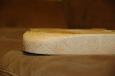

As the first pic shows, I started to add a gentle forearm cut - this stuff is indeed, rather soft, and can be worked pretty easily with just sandpaper & patience.  The second pic is the neck after I think 2 coats of TruOil.  That would have been a few days ago, put on a 3rd coat today.

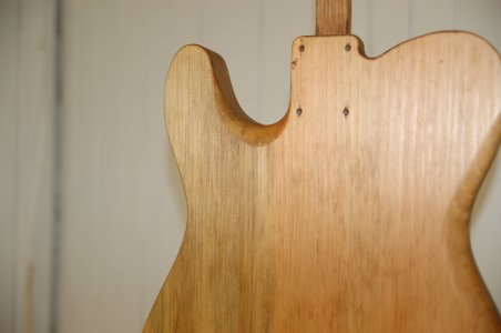

I started to use a sanding drum in my drill press to carve away just a bit of space at the bottom of the cutaway and. . . yikes.  The chuck of my drill press is a mag-fit, and doesn't take well to being used with a sanding drum.  It came off & did that bit of damage seen there.  I wasn't sure how I'd go about fixing it, so I put it away for a few days. . .

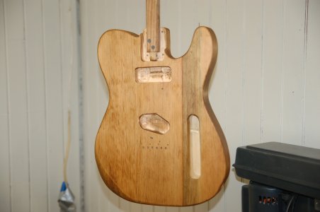

Today, I had a few hours of time to play with, and a newly completed shop/work room in which to do it.  I finished sanding the body edges to get everything rounded, and very carefully, used a sanding drum (with lighter grit paper) to finish carving out the back contour & eliminate the ding.  A bit of wiping with a cloth later to get rid of the dust, then a wood conditioner, shortly followed by a coat of Minwax "Early American" colored stain.

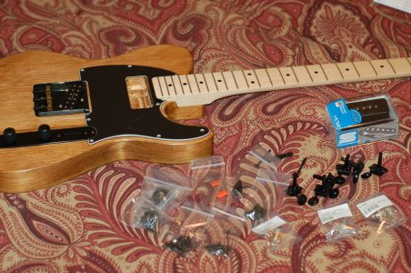

Finally had all the parts come in, so assembly isn't too far out - a few more coats of semi-gloss poly, and increasingly fine sandpaper usage and it'll be done.  This pic shows all the stuff, but I still need to carve out a bit more of the neck pickup hole, which will be after all the finishing is done.  Huzzah for finish scratch covering pickguards.  :toothy12:
