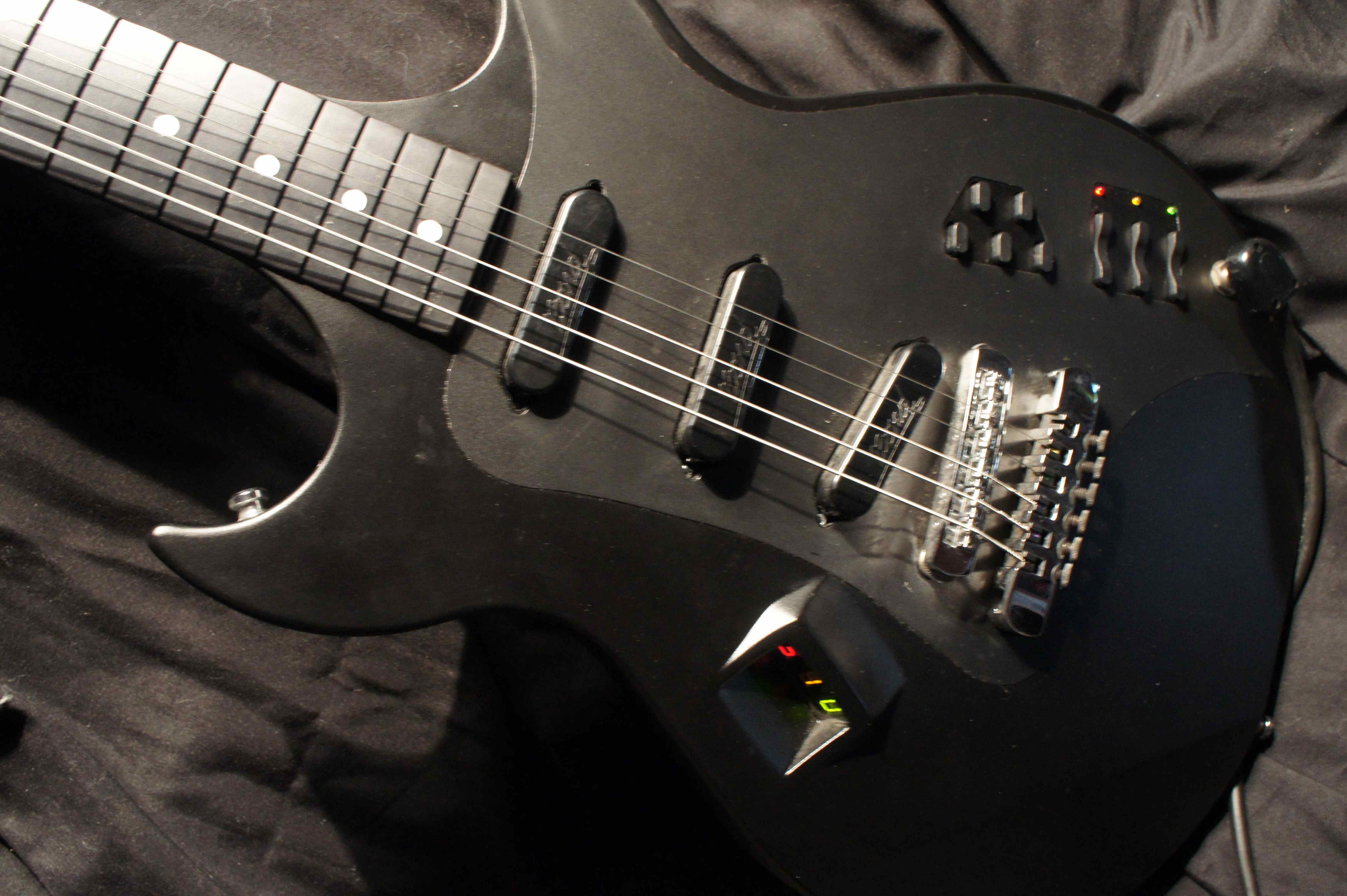

The only thing I can think of is this:
These solved lots of problems
Holy moly, that's a bit more complicated what I was envisioning.  That thing looks like you could fly a drone with it!  :eek:
Sorry, but I can't actually tell if you're being sarcastic here.
