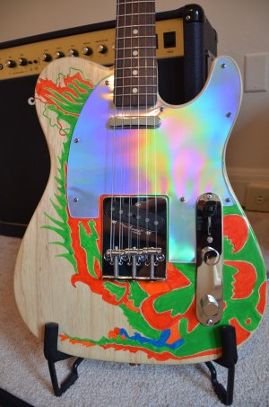

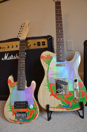

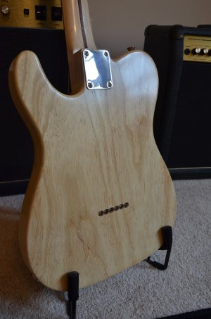

A few pics of two guitars I just finished. The Telecaster is a Warmoth Body and neck, some details below. The small guitar I made for my 3 Y/O grandson - his mother painted both bodies. The goal was to capture the late 60s vibe and esthetics of the original while incorporating some modern player features. The Warmoth parts worked out great so definitely glad I ordered from them.
- Body: Modern swamp ash Telecaster
- Neck: Vintage Modern, standard thin profile, stainless steel 6150 frets
- Finish: Hand painted, 12 coats of wipe on satin poly after grain filling
- Tuners: Gotoh vintage style locking tuners
- Pickups: Fender Pure Vintage '64, set
- Bridge: Gotoh "in tune" convertible top loader with titanium compensated saddles
- Controls: 920D Custom with CTS posts, Orange Drop Caps, Top Hat switch tip
- Misc: Fully copper shielded, custom pick guard
