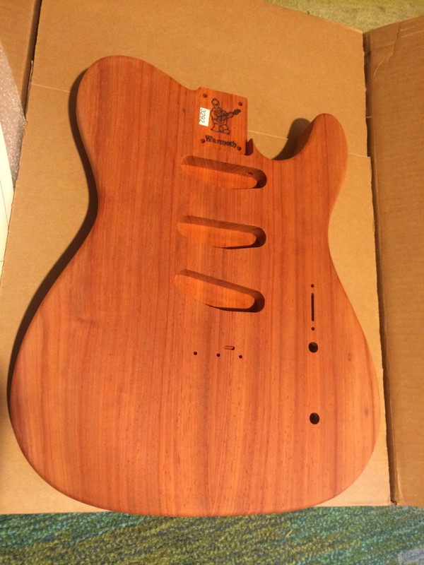

Body just arrived:
Neck is presumably coming within the next few weeks.

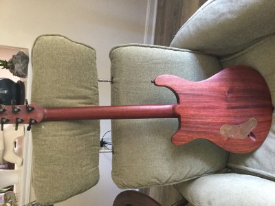

Here is a current picture of the guitar as of today.
As to your question, I keep it in the case and use it about once per week at home for practice, and once a month at my church.  I have never used it outdoors so it has not had a heavy UV load.
I suspect that the biggest contributor to browning is oxidation, which any good finish will help with.  I have an unfinished piece (somewhere around here) from the same blank of wood that has browned (still with red in it).
Hope this helps.
