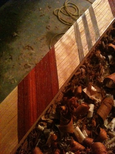

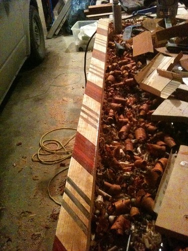

Made this xmas stocking holder for my wife out of cherry with padouk and walnut inserts.
Tung oil.
Better pics on my wiki eventually.
The padouk did not take so well to the tung oil... Must be the wax. It entirely chose to reject my reality.

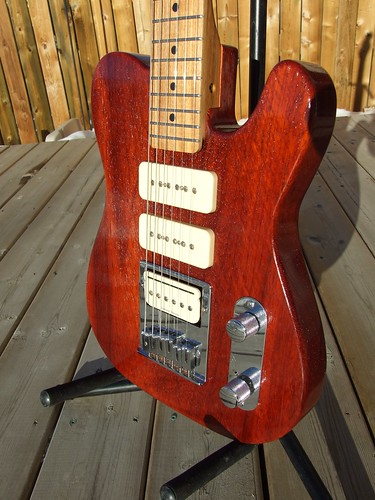

I also have this neck:
When this pic is taken, it's about 10 years old, never been finished, in and (mostly) out of cases. You can see the faint transition where it was mounted to the body for 7 years or something. Still red though.
And then there's Gordita, finished with wipe-on poly. Still red, but only a year old.
