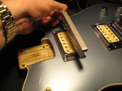

This is why I use a small tuning fork to test coil wiring rather than tapping on pole pieces. It's a non-contact way of exciting the coils, so there's no electrical or mechanical crosstalk.

If you hold the tuning fork right, the effect of the thing is very localized. I hold it lengthwise along the pickup, with the fork tangs perpendicular to the coil(s). Move it from one coil to the other, if there are two. That'll tell you which coil is hot or not, or both. You can also check your volume and tone controls, as well as your switch(es) while you're at it.
If the wiring is wrong, you'll have to suss that out on your own based on the responses you do or don't get.
Edit: resist the urge to bang the fork on your guitar's body. It won't do the body any good at all  :icon_biggrin:
