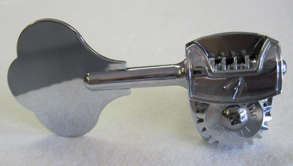

Well, BigSteve, if I'm gonna do it, I'm gonna do it.  It's already shaping up to be "one of those builds" ya know.  I've been accumulating those top notch parts for just such an emergency.  Like a pristine BadAss II bridge and the Fender Deluxe tuning machines.  I figure, hell, why stop now.  Let's make it something special.
