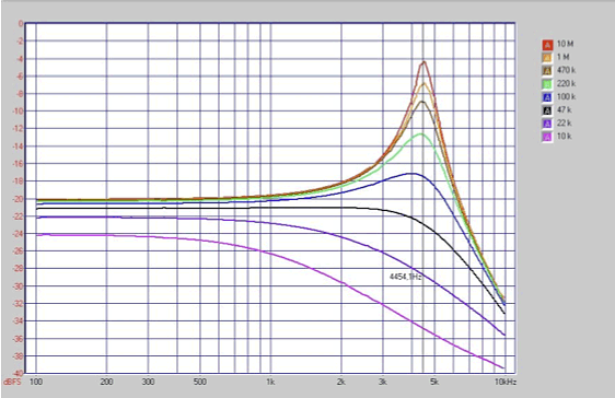

Aaron, did you use 500k pots or 250k pots with the JB? It's also by far my favorite humbucker and I have found it to be super good on both 250k and 500k.
The JB can definitely take on a different personality based on 500k or 250k pots. And over on the Seymour Duncan forum, members have put basically any and all magnets into the 59 and they all work to customize the sound.
Interesting! How would you describe the difference? I just noticed I've always only used it on 250k and it's sooo heavy already.

For any pickup, going from no load, to 1M, 500k, 250k, 125k etc. of total load reduces the resonant peak of the pickup. (We are accustomed to vintage Fender style pickups with dual 250K, so 125K total load if a tone control is selected, which tames the brightness of them. You can do no loads or 1M and it’ll really increase the cut of the tone).
On the JB, the resonant peak is that somewhat chirpy attack that you either love or hate about the JB. If you want a little more of that going to a 500K will bring it out, if that’s something you don’t like about the JB, going from 500K to 250K will smooth it out.
I think you need that peak. It’s what makes the jb the chicken of the guitar world. It goes with everything.
