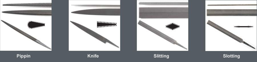

3. Can you tell us exactly what file you used for the knockout slot for the b-string on the end of the bridge plate? I have a Dremel I would be tempted to use, but I take your concerns about high-speed rotating tools being hard to control very much to heart.
I used a couple of them. First a regular triangle file to get things started, and then a wedge shaped file that also has cutters on the thin edge of the wedge for the rest of it. I'll see if I can find a photo of it on-line somewhere...

Hey! I found out what that file I use is called. It's a Pippin File! Never knew before...
hmmmm.....I always thought that was a Meriadoc? Great video btw. I know I will never be attempting that!
