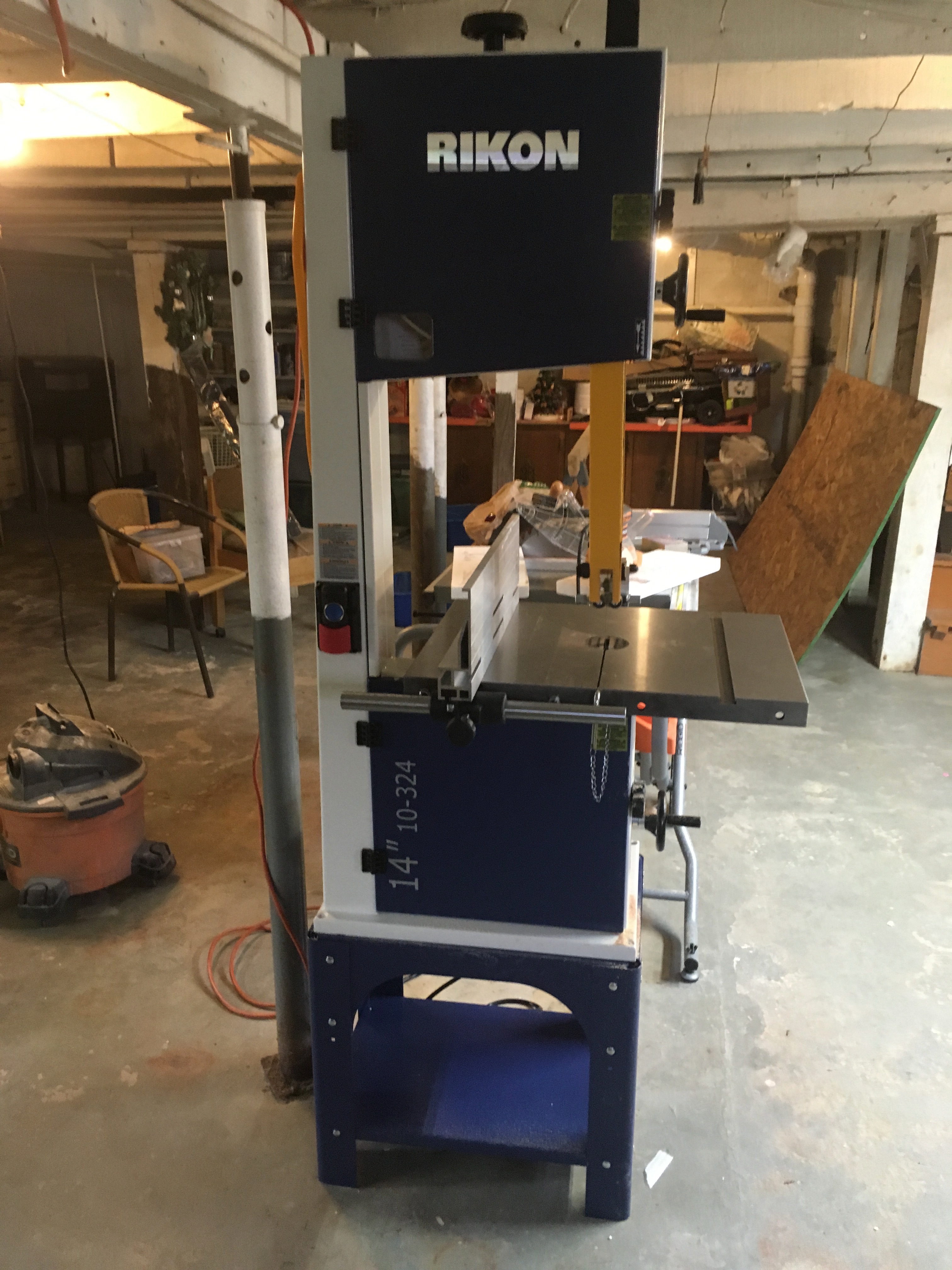

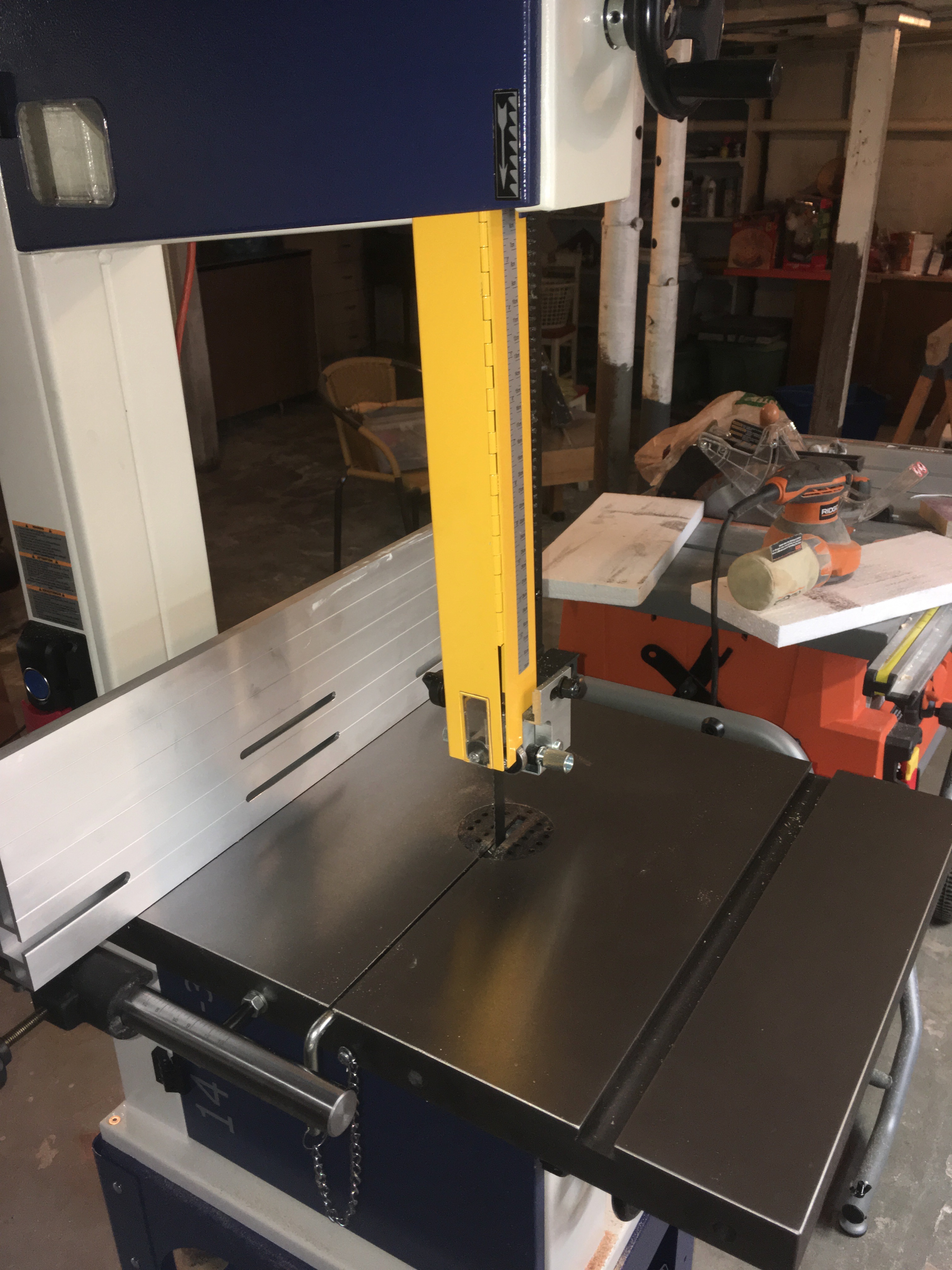

Goodness gracious! New band saw? What did you get? Inquiring minds want to know. And their sensors wanna see pics!
I got a Rikon 10-324 1.5 hp 13 7/8 width of cut and 13inch re-saw capacity!

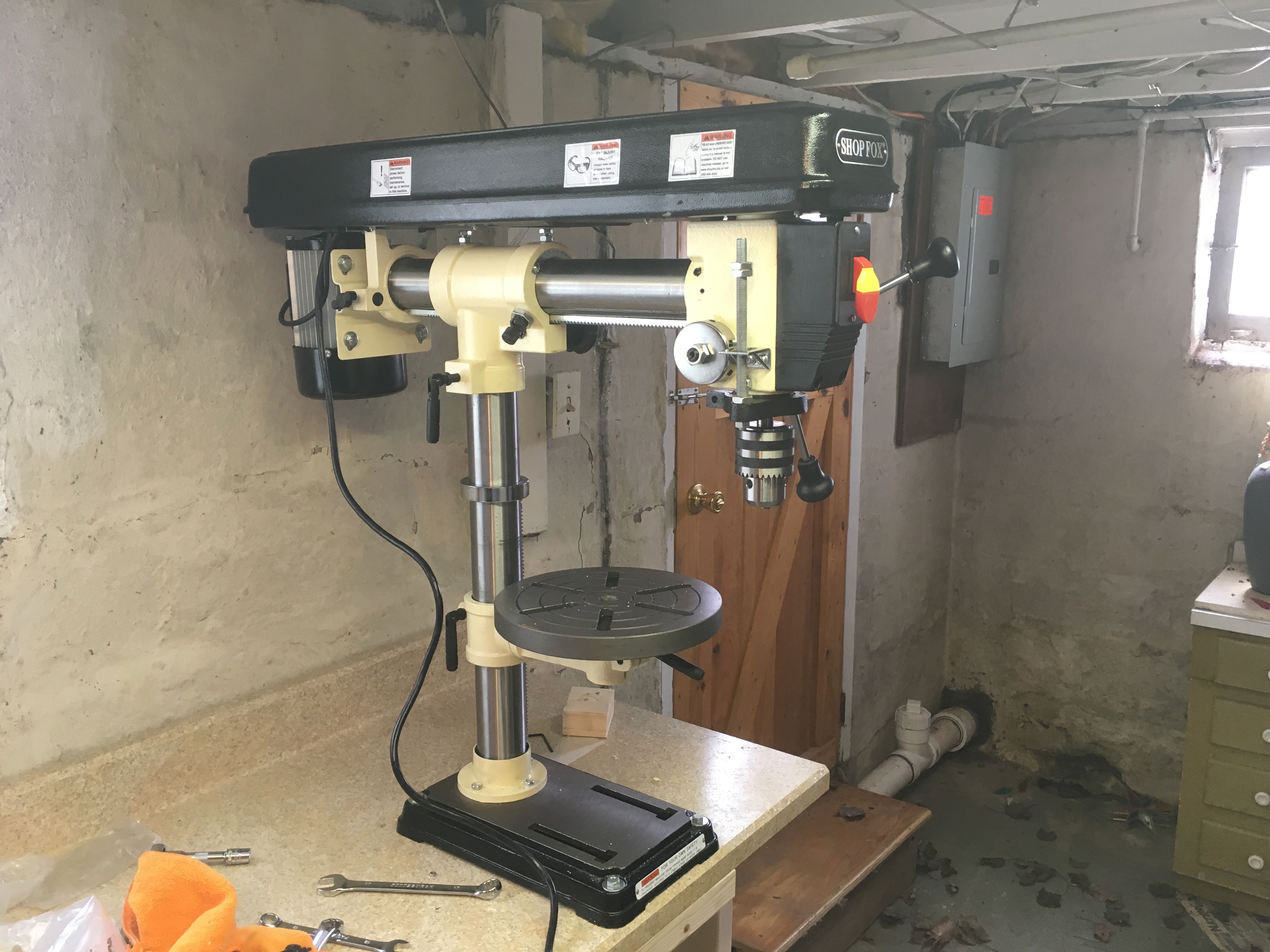

I also got this drill press last week, ShopFox radial drill press 34 inch radius capacity so 16 1/2 inch from chuck to pillar.
My shop is coming along, next week I am building a few more work benches to clutter up.
Nice! Now all you need is some wainscotting for the walls, some berber carpet, some mood lighting, a wet bar...
