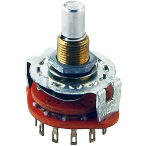

Aside from a push-pull (or push-push) pot, which would be my preference, there are rotary switches if you want to add more than two settings.
