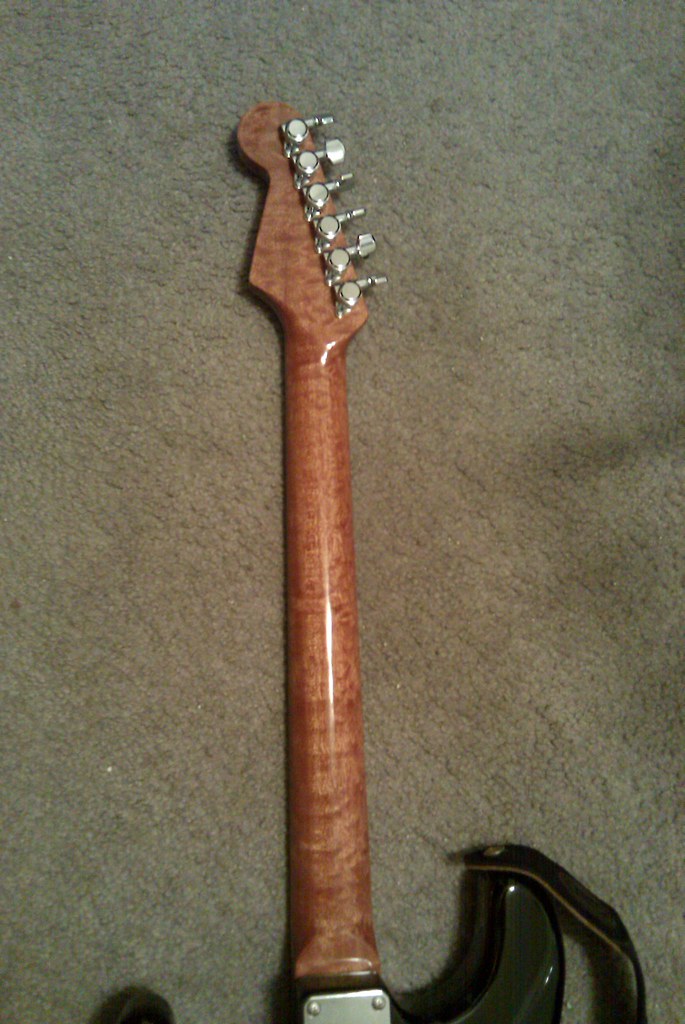

The heel shape has changed. It's smaller than the older style like pic1.
Here's current heels:
and here is my neck that I got just a hair over 2 years ago:

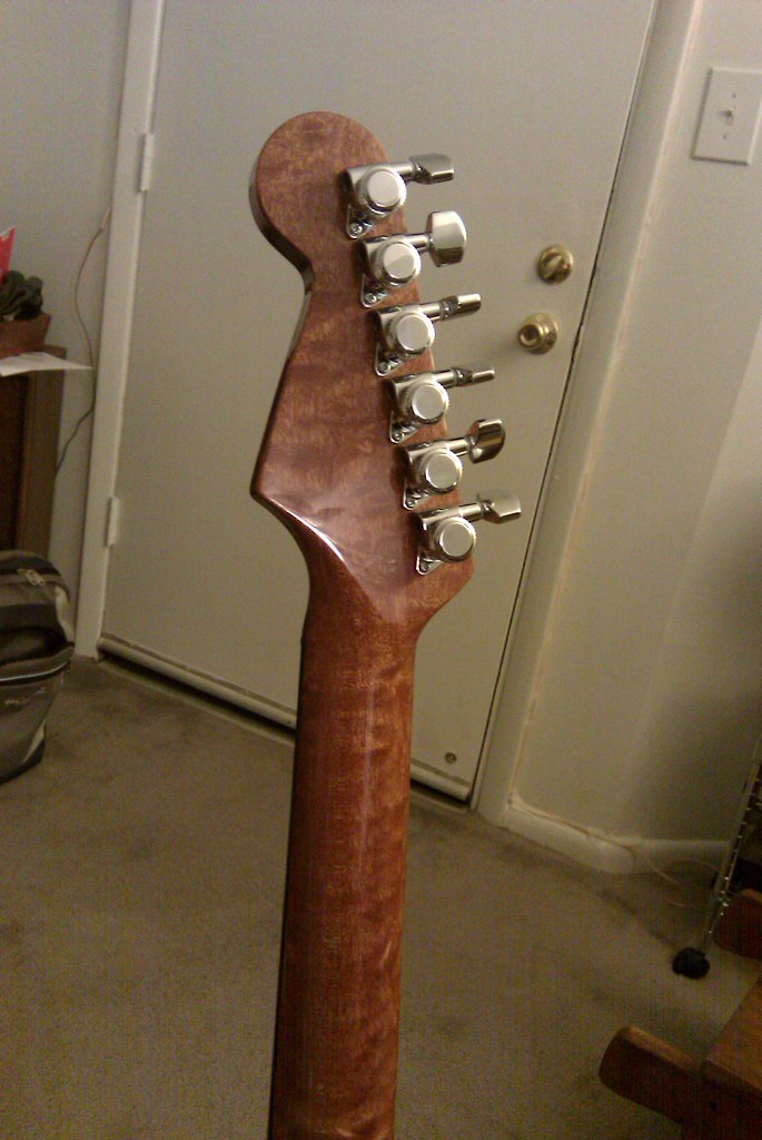

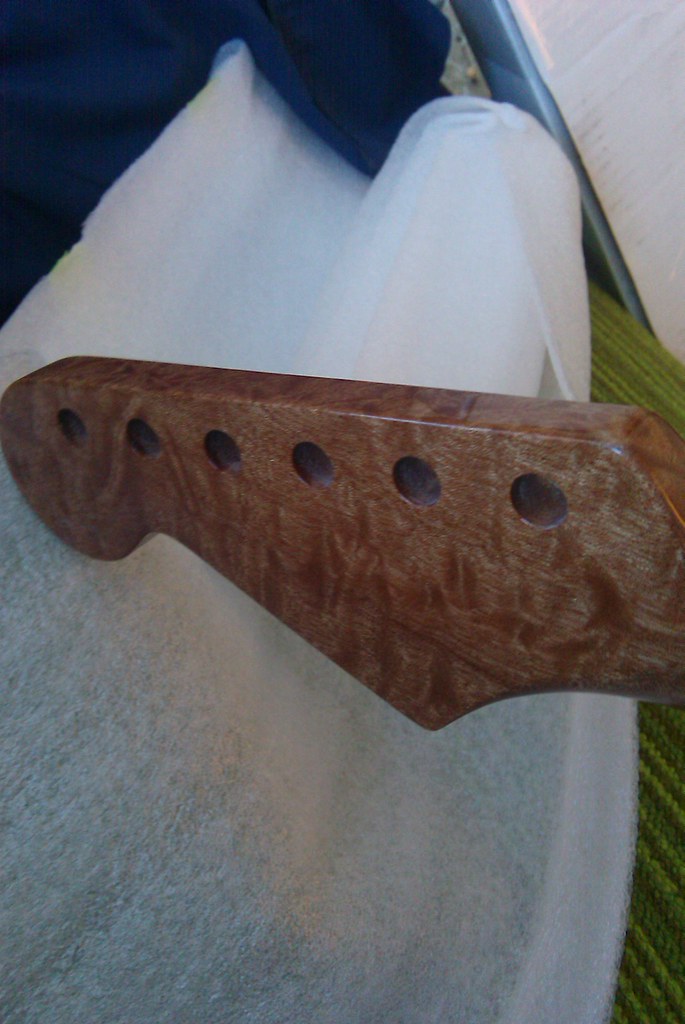

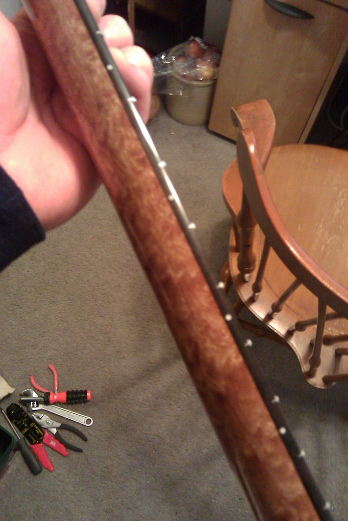

I've heard figured mahogany is somewhat rare. I bought it from the showcase.
Optioned out with SS6105 frets, Graph Tech Tusq XL nut, gloss finish and schaller locking tuners

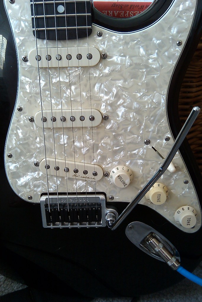

this last one is to show the boogie rail bridge (much better than the 6 point)
