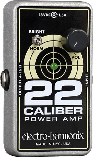

I got the .22 Caliber mainly for portability (gigging) - I have a rack SS power amp but it's of course heavy enough to put in the "lug around"
category... theory here is (a few rig options):
slaved head
FX
2nd amp (combo amp)
-or-
slaved head
FX
rack power amp
speaker(s)
-or-
slaved head
FX
.22 caliber (pedal sized power amp)
speaker(s)

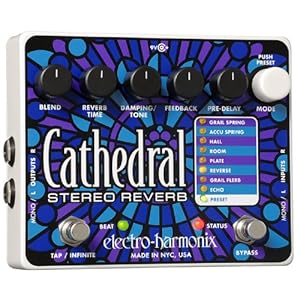

EH Cathedral RAWKS - everything I expected it to be.  This is the best vid I've found which
shows what it can do... and mind you, in stereo if you want:
[youtube=425,350]http://www.youtube.com/watch?v=K2-28drzvtk&feature=related[/youtube]
Suhr ISO Line Out also doth rawketh... it's cleaner (not as hot a signal) than the HotPlate
line out and made my slave tone even better.  However it can really crank the output - I currently
have it at "one" on the dial.
The .22 Caliber suprisingly sounds good just on its own.  Aside from being a useful tool
for slaving/wet-dry, it also can serve a purpose for a backup amp in case yours goes down in
the middle of the gig.  Gets pretty loud too; however it does start clipping past approx
2 o'clock (if you want clean headroom I'd venture the .44 Magnum would do better).

This little side-benefit to slaving also provides the opportunity to place FX
*after* the amp, just like you were in the studio micing your speaker, then going to
the board (or DAW) and adding FX to the guitar track at the console.
The FX that benefit the most with this setup are time-based such
as reverbs and delays.  Far clearer repeats and echoes are heard
as compared to sticking the 'verb/delay in front of the amp (especially
when you add clipping/distortion).
So for those who have amps without FX loops but want great
sounding FX, this is the way to go.

Interesting. Are the EHX poweramp pedals transparent sounding? How loud do they get? Or to put it another way: correctly set up, would this sound any different from my AC15 without slaving?

- 'Are the EHX poweramp pedals transparent sounding?'
On it's own, the .22 Caliber has a decent tone and it starts to break up around 2 o'clock.
As far as transparency, I've yet to try my aforementioned rig with the .22 cal.
- 'How loud do they get?'
I cranked the .22 cal:
guitar
.22 cal
speaker
...it's approx as loud as my Deluxe (roughly same wattage) - loud
enough to rumble the walls in the room somewhat, but not earth/head-shattering like a 100 watter.

Update:  Tried the .22 as a poweramp last night at solo practice levels (not pushing
it into distortion), and it worked great.  As with any kind of slaving/post amp FX, the
2nd power amp(s) will ever-so-slightly color your tone, just as my recent
slaving-one-t00b-amp-into-another-t00b-amp project does.
The .22 should work for small gigs and practice... I'd think you'd want the .44
for larger audiences if sticking to the E-HX pedal format... and if you need as clean
a poweramp as you can.  Otherwise you can crank the .22 and it will add some of
its own clipping to your tone.
So to answer your stock amp transparency question, the amount of
transparency depends on the power amp you're using and whether or
not you're pushing it into distortion (how much clean headroom).
