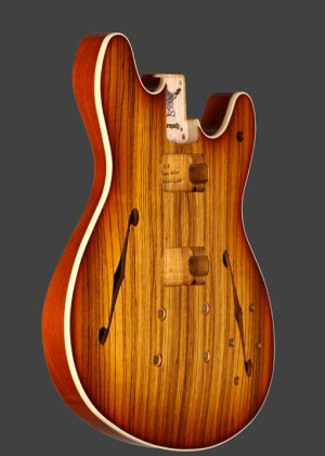

Mooncaster builds? Let's see em'!
Logrinn said:
That is absolutely stunning.
About drilling a new hole - have you considered using a master tone (or volume) and put the Varitone in the other hole?
Funny you mention that, I was just thinking about this before you replied.
The question is, would you rather have a master tone, or a master volume?
Lots of possibilities here, I like it!
I'm not going to drill an extra hole. Maybe I'll just do volume, volume, master tone, varitone. I could get push / pull pots for the volume knobs and have those split the humbuckers, right?
Don't go too crazy. You'll be wiring for a week only to find out in practice you only use 20% of what you installed.

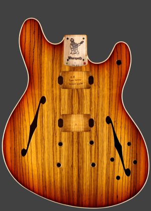

They're nice. I put one together for a gentleman in Australia...
The only thing tricky about them is if you ask for the pickup selector switch to be drilled in one of the horns. The way the bodies are made, there's no easy way to get that thing mounted. There just isn't enough room in there. You have to use one the "L" shaped Switchcraft switches...
...and even then you're in for a fight. Warmoth really needs to put an access panel of some sort behind the thing.
