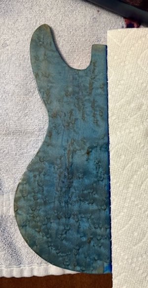

Mixol Tinted nitro on birdseye maple experiment.
Hagwood
835
Well I had to redo my meadowhawk neck finish after a mishap, so while I was figuring out the amount of blue dye to use I practiced on a piece of birdseye maple. Very light tint and thought it looked really cool. Obviously a little splotchy, but that was just one light coat. I like the subtle color look on the Birdseye, maybe a future build idea……😁IMG_0482.jpeg
It is difficult to make figured veneer/ wood look bad. It is the low hanging fruit of the partscaster. IMO
Oh I wouldn’t say that. I’ve seen some very nice figured wood messed up from bad finishes. Bad prep, bad dye job, bad burst, bad clear coat…….
It’s fun trying different methods. I usually use Keda dye, but the tinted nitro is a pretty cool look if you use a spray gun. It’s especially good for doing Heritage Cherry on Mahogany, another one on my list. Also Playing around with spraying a burst as well with a very narrow pattern and low pressure.
pssssst........................chain yank.........................
I find the Mixol blue pigment no. 9 over light wood can run a little warm, possibly inching toward the turquoise. This can be attractive, but is not really my cup of tea. I've gotten a really nice deep blue mixing the blue no. 9 with a light squirt of the no. 11 violet. My results have been on ash, though, not figured maple, so YMMV.
Thanks, I need to order some more colors to experiment with, but I did mix a touch of red in the blue for the Meadowhawk back and neck. I think you're right about it being to warm.
