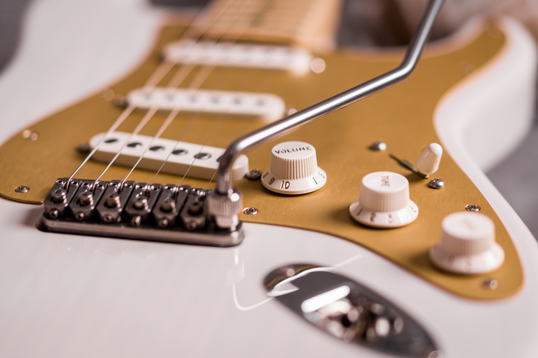

I had a maple American Professional Stratocaster neck sitting around from a build that never happened, and I've been getting into winding my own pickups lately so I decided to jump on the vintage spec Mary Kaye body that was in the showcase a few weeks ago to have a single coil testbed guitar.
Specs:
Vintage Spec Strat body
Swamp Ash
SSS route - 6 screw tremolo - 4lb 5oz
Maple American Pro Strat neck
Fender locking tuners
Fender anodized gold pickguard
American Professional style wiring w/ treble bleed
Vega Trem system - it's flat out awesome. Pricey, but it has all the tuning stability and function of a floyd rose but looks nice and sounds like a traditional strat bridge system. This is the 2nd one i've used and I think I'll use them going forward.
1/4" A5 rod magnet single coils in neck and bridge - 43awg enamel. 9.4k neck - 8.5k middle - 10.31k bridge with a steel baseplate attached.
currently a 15.8k bridge wound with 44awg, but I think it's a tad too dark and compressed compared to the 10.31k one, which sounds like the best parts of a P90 and tele bridge put together. I'll swap the 10.31k one back in next string change.
I really like Duncan Quarter pound pickups, but was annoyed they only come in black, and always wished they would fit in normal strat pickup covers. So I decided to wind my own that would, lol. I take standard strat pickup covers and stick them on the drill press to enlarge the holes just enough for the pole pieces to have wiggle room. I first tried a hand drill but it mangled the holes, and with the drill press the holes are super clean and i'm able to "kiss" the covers with the next size larger on a step bit to clean up the holes.

That's a beauty of an axe, for sure.  The Vega trem is a handsome part.  I like your workaround to duplicate Quarter Pound functionality in a non-black pickup, as well.  I salute you, intrepid guitar-hacker!  Also, the photos look just dandy, to my eye.
That's one beautiful guitar. MKW really does look good on this one.  :icon_thumright:
I don't think I have ever seen a MK finish with and anodized gold pick guard. It looks killer! Nice Job.

I first picked one up off of Reverb about 4 months ago, but they appear to be sold out most everywhere currently. I talked to the Vega-Trem guys about 3 months ago wondering if I could buy the adapter for the 6-screw trem seperate since the first one I ordered was a 2 post for a different guitar. Their production is still shut down from the virus so they don't have any tremolos or extra parts on hand currently, but f-u tone still has a few units available.

I'm not usually a fan of gold plated parts, so also not usually a fan of MK Strats, but that works really well. The minimalist-looking Vega trem looks very interesting.
