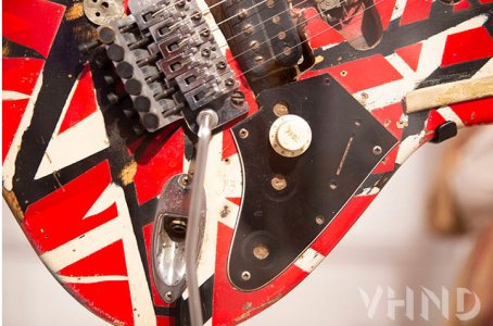

Holy smokes, I’m only just now realizing that I have the tone and volume knobs swapped lol. Don’t read the knobs, the pots are in the right place
Hey, if it's good enough for Ed, whose Frankenstein guitar has the "Tone" knob on the only (volume) pot...
