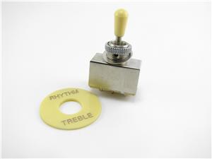

Thanks guys. We finally got a chance to pull this apart on the weekend. Turns out the 3 way switch wasn't making contact in the neck position. One of these cheapo jobs.
Once I changed this out for a good quality switchcraft one it was all then OK.
