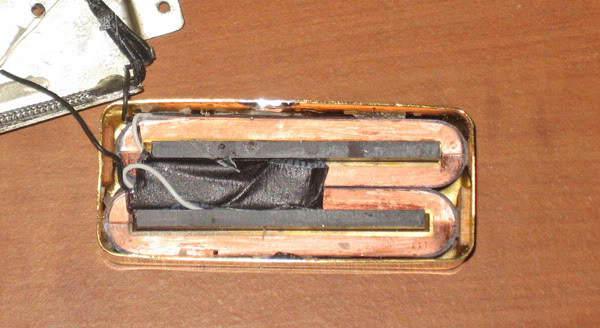

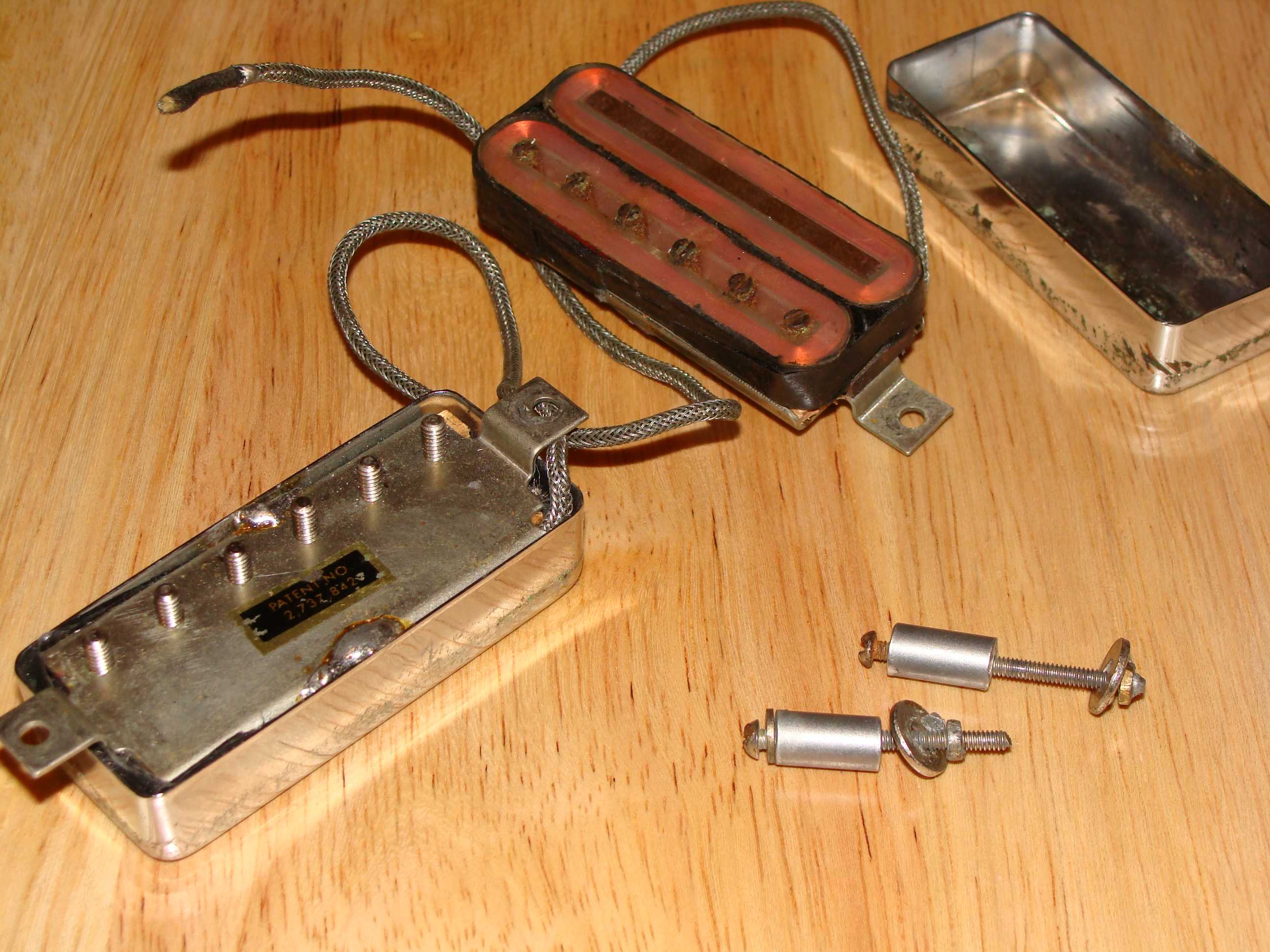

For those who haven't dissected both, both pickups use the same base plate, have the same footprint, and (to a degree) the coils are identical. The difference is the magnet and pole pieces. The Firebird PU originated as a cost-cutting version of the mini-HB.
When Gibson bought Epiphone in '58 and moved production to Michigan, they designed the mini-humbucker to replace Epiphone's anemic New Yorker PU. But these are probably most famous for the '70s Les Paul Deluxe and SG Deluxe models. These PUs are made similar to the PAF-style humbucker. They have steel pole pieces that touch a bar magnet underneath the coils. One coil has the threaded, adjustable pole pieces, the other has one large steel slug.
Gibson_Les_Paul_Deluxe_Mini-Humbuckers_%28Patent_No._2%2C737%2C842%29_rear_side_%26_cover_removed.jpg
When Gibson designed the Firebird, they decided to redesign the PUs to make them faster and cheaper to build. Instead of steel and adjustable pole pieces, they use two alnico magnets as the pole pieces, like with Fender PUs ... the pole pieces are the magnets.
This minor difference makes a big differences in tone. IMO, the mini-HB are smoother and more balance, with a lot of clarity and top-end. Like a fat strat PU. The Firebird PUs have a punchier low-med, scoped mids, and a aggressive, raspy to end.
But, like with all PUs these days, the options for aftermarket blur the lines a lot. For instance, the ubiquitous Seymour Duncan mini-humbuckers look like Firebird PUs, but they are actually a hybird...two steel pole slugs with a magnet underneath. SD does make a more authnetioc version of each inder their Antiquities line.
At one time I have a good half dozen Gibson embossed versions of each, but these are a nightmare to rewind, much tighter packed than a normal humbucker, so I think I eventually tossed them.
