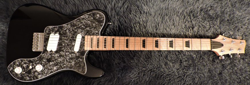

No.  Wood will have to be removed to fit an angled humbucker in a standard humbucker rout.  Had to remove extra at both positions to get the result pictured.  Didn't take much time with a forstner bit and drill press though!    :headbang1:

I love this bridge route, but I think that I would make 2 routing templates of my own based upon the EMG S route; 1 for rear route, 1 for pickguard route.
