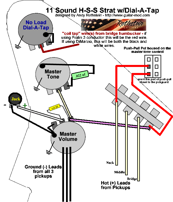

I finally found a nice wiring diagram that I'd like to try out:
http://www.guitar-mod.com/rg_dialatap_11.html
What I don't understand about this wiring diagram is the vol kit yellow thingy beside the volume pot and the no load pot. What are these electrical components? I assume the no load pot can be either 500k or 250k, because it doesn't matter, but what's up with that vol kit? Has anybody tried this particular wiring?
The "Volume Kit" is likely what's usually referred to as a "Treble Bleed" mod. Basically, it's a capacitor or capacitor/resistor combination that's used to maintain your high end as you turn down the volume. For noiseless pickups, it's usually just a .001uF cap. On single coils, there's often a resistor in series or parallel. The article linked above explains it in much more detail if you're interested.
The "no-load dial-a-tap" is just a pot that takes one of the coils on your humbucker to ground in varying degrees, so you can go from a humbucker to a single coil gradually, rather than switching it all at once as is normally done. The "no load" part probably refers to the type of pot it is, where at one extreme of the rotation the pot actually opens up, so there's no load on the circuit.
So the pot value does not matter, right? Whether it's a 250k or a 500k, both work, correct?

I'm sure either would work, but one may sound different than the other, or behave differently due to taper/impedance interaction. I can't say which is more practical or desirable.

250k is far too direct of a load on the coil to give you the behavior you want when you don't want to use the control. (Assuming a typical pickup impedance.) The idea with that sort of thing is to have a resistance that approaches infinity at the end of the rotation, so that you can bypass the control when you want to. That would usually be accomplished with a higher value pot on an audio taper, so that the resistance at the end is high, but rolling down just a hair will take you down into a usable range of control.
All makes sense, but they've used a no-load pot, so the load with it turned all the way is infinite (as in, it's just disconnected). However, I would definitely say to use a 500K no-load pot for the spin-a-split to be safe.
I have used 250K volume and tone pots with the Li'l Screamin' Demon and it's fine - you get more brightness than a regular humbucker anyway, because of the narrower sensing window of the pickup.
I have a short-shaft pot in a rear-routed body and it fits just fine. There will be room for a push-pull pot in a rear-routed soloist - they're about the same depth inside the body as a 5-way blade switch.
For the volume kit, wire a 100K resistor and a 0.0022uF capacitor across those two lugs in parallel. You don't actually have to do this, though - the effect is that treble is maintained as you roll off the volume, but on some of my guitars I actually like to have the treble reduce a little more as I roll off. It's just a personal preference.
