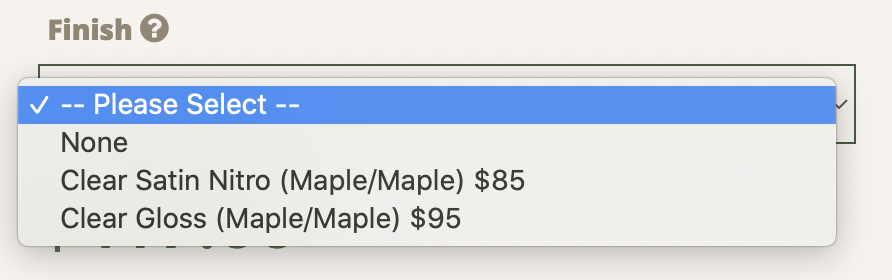

I'm only going for a maple/maple neck with standard dots/inlays.  Not sure why the option doesn't come up for me...

Can you post a full screenshot of all the builder selections you're making?
Yes, this. We need to know exactly what product, and whether you're using the custom builder or choosing something from the showcase.

It seems like scallops are the issue. Not sure why though...

I did the most vanilla build possible (sorry, can't screen shot the whole list). Tele neck, modern, maple/maple, standard thin, 6100 frets, standard dot inlays... If I choose scallops then I can't choose vintage tint. If I remove scallops then vintage tint shows up again.

Ah, now I see. The problem isn't with the scallops directly, but rather that the choice of scallops prevents the binding option from being displayed (can't have both) and the Vintage Tint option relies on a value from the Binding option to know whether to become visible or not. This is because we are trying to prevent people from ordering White binding, and then getting Vintage Tint over the top, which would turn it yellow.
So what's happening is when you arrive at the Finish option, the builder looks back to make sure you didn't choose White Binding, but there is no value for Binding at all, so the website shrugs is shoulders and doesn't know what to do.

OK.....give it a try now.
I've changed it so that if you choose Scallops you are still forced through the Binding option. That way a value for Binding is present once your reach the Finish option.
