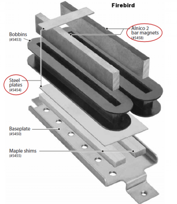

From your linked site:
What Do Firebird Guitar Pickups Sound Like?
Firebird pups occupy an interesting and unique place in the sonic landscape. One of things about them is that traditionally they are fairly low output. Gibson did reissue them in 1990 and those versions are quite different, using ceramic magnets and are wound much hotter, I’m not talking about those.
The originals by Gibson used AlNiCo magnets and the DCR on vintage originals was generally around 6.5k, some higher and some lower depending on actual thickness of the “42awg” wire. I’ve seen some 60s vintage bridge pups reaching 7k. Bicentennials are typically between 6 – 6.5k, often on the lower end of that spectrum. Here are some sound clips demonstrating how they sound:
It doesn't say A2 or A5, but the consensus is A2.

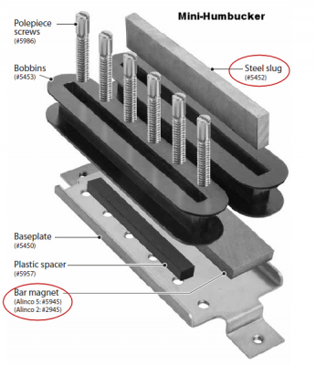

Les Paul Deluxe/Epiphone construction...
Firebird construction:
Seymour Duncan is more like the former, except with two steel lugs.

You are the fount!  Do you know anything about the construction of DiMarzio mini hums?  The Vintage MiniHum neck model is one of my favorites.
Ceramic bar magnet underneath, six non-adjustable steel poles per coil.
I see what you are saying. Also, the diagram definitively shows that no Firebird pickup used "alnico 2 Slugs" as pole-pieces (per your post), rather they had alnico 2 BAR magnets instead.
Correct? :icon_thumright:
From the information I can find, the Duncan SM-1 is a vintage correct 2X bar magnets (albeit A5's)
but the SM-2 and 3 are not. I am now interested in de-soldering the cover and having a look myself but am afraid to ruin one as I do like them. If the SM-1 was good enough for Johnny Winter, it is certainly better than I need!! :laughing7:
Anyway all very interesting!
Thank you for that. I was going to rip out my hair noting the construction of  a Firebird pickup shares very little with a mini humbucker.  Thinking it does likens a 2 door convertible to a 2 door pickup.  Yes their both cars, and yes they both have 2 doors,,,,, but,,,,,
