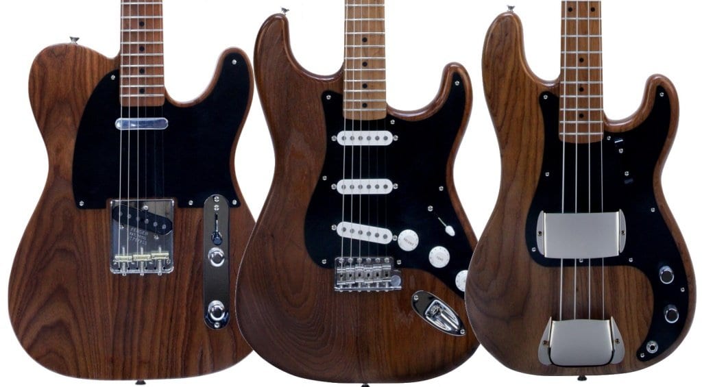

In the end, I'd like it to be fairly similar to Fender's RSA guitars, but perhaps with a bit more contrast between neck and body:

I would imagine that those Fenders are finished with a clear lacquer. No dyes at all involved. The roasting process seem to make all colors much darker than normal.

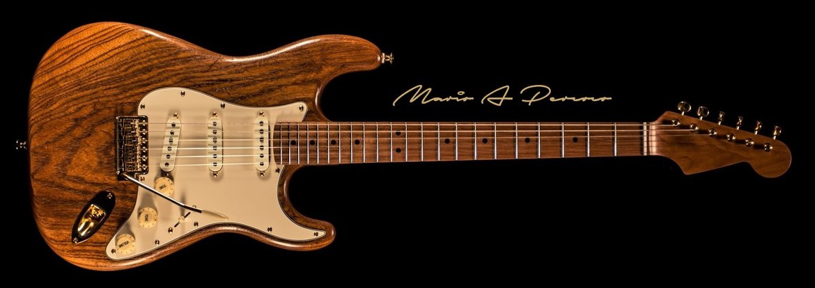

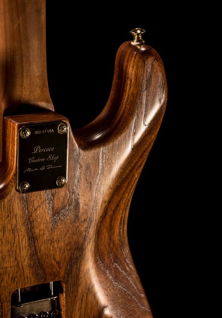

I'm also considering a build with a roasted ash body and roasted maple neck. I'm looking to do an oil-based finish that looks something like the guitar below. I don't want a glossy finish (more like satin) and I don't mind some grain texture coming through in the body (like the second photo shows). I've been reading up on Tru oil and tung oil and the processes associated with them but there seem to be so many approaches that I'm not sure what the best route forward is!
