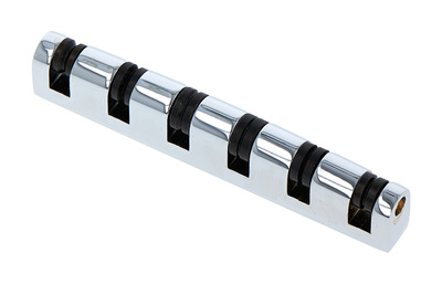

I'm considering a Graph Tech TUSQ XL, an Earvana, or possibly even a roller nut such as the LSR.

I generally use Tusq nuts with Wilkinsons and don't have a problem. The LSR is the ultimate nut to have, though. I understand not wanting to modify the neck, but unlike installing a locking nut, it's not something you're likely to want to reverse and not be able to.

Looks like the LSR roller nut might only be available in a 1 11/16" nut width?
My neck has a 1 5/8" nut width.  Are there any other roller options that would work for this neck?
Ah, sorry. Forgot to consider that.
A company called "ABM" makes a roller nut in that width...
Allparts sells them, but they're somewhat pricey. Not that LSR nuts are cheap - just sayin'. Also Thoman, if you're in Europe or don't mind waiting a bit for delivery.
