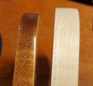

P Bass neck Fender (Left) and Warmoth (Right)
WTF???
To thin this out, I guess just sand an entire 1/8th inch off the rear of the neck?
WTF???
That 1/8th of an inch is where all the tone lives, sand it off and you'll kill it!!!! :icon_biggrin:
er, it's like that because that's a better way to build it.
as I said, 10 years ago now it seems (!) as long as the tuners fit, you're good
Okay, by the numbers. Just a few to get an idea. Headstock Thickness from random guitars pulled off the shelf from Danny D's Music Hacienda in League City, TX. Pete did the measurements himself and we can conclude that there is an acceptable range that falls withing the Fender "Guidelines" (Term used loosely like drop tunes strings)
