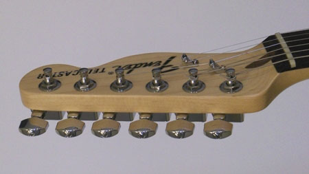

There are a lot of bound headstocks in the wild, but not on Strats. They exist, but they're pretty rare. Strat headstocks have a 3 dimensional surface, while bound headstocks are usually two dimensional. Binding is flat, so it'll bend around gentle inside and outside curves with a little coercion, and tighter inside/outside corners can be mitered or bevelled, but it doesn't want to bend up and down at all. You'd need to do that with a Strat.
Basically, I want something like this...
To me, that binding looks great, it's a continuation of the neck binding. If the guitar is bound, the neck is bound, the headstock should be bound to complete the look. Would some sort of natural mask / veneer thing be possible ?
Could you get the face of the headstock painted black and then paint your own binding?  i know it wouldn't be the same, but....
Fellow forumite, Rightintheface, painted the binding on his hollow tele.  Came out quote well.....

note, that Pensa headstock with the binding is NOT 3-dimensional like a strat headstock is. it is flat. (I would love to have binding on a strat headstock, too . . . I may paint on mine and/or try to put the real stuff on myself.)
and to jimh: did rightintheface's tele have faux binding on the neck?
It's just a different shape.  The transistion from the headstock face to the nut isn't the 3D area in question?
It's tough to tell from that picture, but it does sorta look like the headstock is flat (2D). That is, no depth changes on the face anywhere.
I'm totally confused. What makes a Strat headstock more 3-dimensional than the headstock on any other guitar??
Most Fender headstocks are not planar. They have depth.
Look at the side view of a Fender-design headstock.
You'll see that the wood changes elevation from the nut to the first tuning machine, then flattens out for the rest of the head.
On many or most others, there is no change in elevation. The entire headstock surface is flat.
