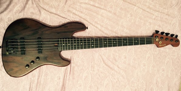

I did confuse you, sorry.
Here's some pics of my Jazz 5.
Hopefully the fretless neck should easily fit in :)
Best,
Samson
