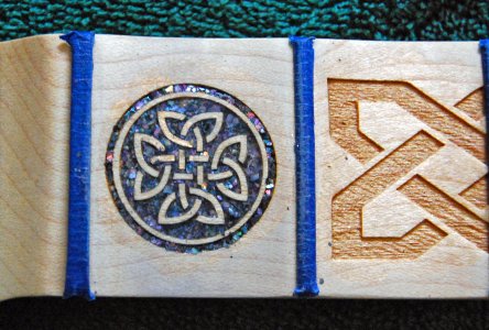

Look for someone in your area that can do engraving using a CO2 laser. I have used this for 2 necks and have less money invested than the cost of StewMac’s plunge router base. The laser only removes organic material and doesn’t harm the frets. You can get as creative with the inlay as you wish. My guy takes vector images and programs them into the cutting machine. You can even cut the mother of pearl to fit exactly into the design cut into the fretboard. I used crushed mother of pearl in the example.
