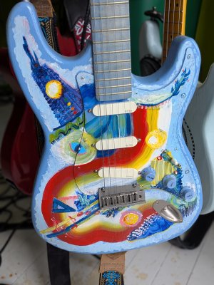

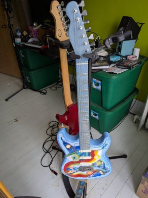

I have a strat with reverse headstock Birdseye tele neck, and EMG pups... It's had Rotosound flatwounds on it since day one, and its still on the original set.
I consider it my "blues" guitar and its kind of a Wedgewood blue in color (including neck and fretboard). I guess its about ten or twelve years old now... Changed the battery a few times but never the strings!!
PS if low tension is your aim, maybe try tapewounds... Labella Gold or copper are super brite sounding with low tension... (Going by their bass strings, not sure if they do a guitar set). My roto flats are not high tension but I built a balanced set up from single strings, .009 thru .044 if memory serves...

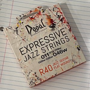

Many moons ago, I used to do advertising and artist relations for Thomastik-Infeld, and i can tell you that almost all of the top jazz guitarists used T-I Jazz Swings. Herb Ellis was one of my "client" artists, for example. That said; I've found a flatwound string I like better than the Thomastiks: an Italian brand called Dogal. They cost at least as much (maybe a little more), and there's only one place in the U.S. you can buy them (Strings by Mail), but they're incredible strings. First of all, they're NOT dull sounding like cheap flats. They're very lively, and they are easier to play than other flats. I have them on a Pinter SB1-J Jazz Jr - a set of 11's, which are perfect for me. My old hands can't handle heavy strings. While they are pricey, they last a very long time, like most flatwounds. They're kind of like an investment in better tone and playability. They're addictive - I don't ever want to use anything else. Here is what a pack looks like:
