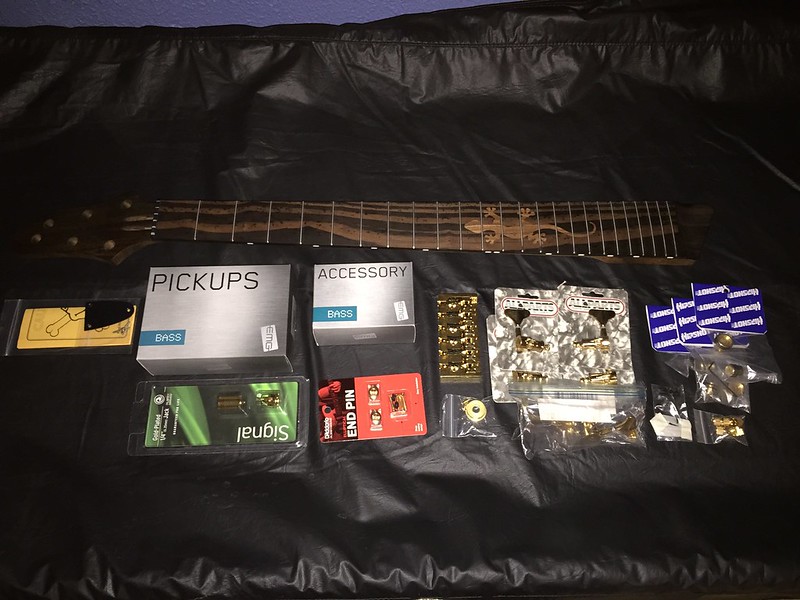

Hi.  I am new to the forum.  I have decided to build this Gecko 6.
The body is swamp ash, with transparent green.  The neck was a showcase neck in Indian Rosewood (!!!) and a gorgeous Ebony fretboard with SS frets.  It will house an EMG 45TWX in the sweet spot and a BQC 3 band.  Hardware is gold and matched to the basic options that Warmoth offers.

Welcome to the forum. You've got some nice parts there.
Take your time and it should turn out fine.
That's a crazy fretboard - crazy good.
Great choices all around.  What's not to love about a green gecko?

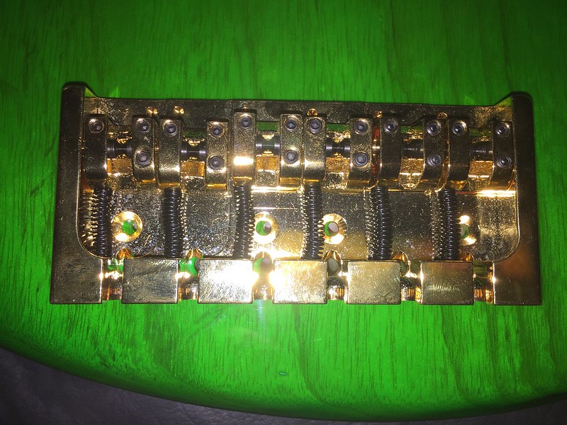

Hey folks - could use your advice on this.  I have the correct .669" spaced bridge for the Gecko 6 but the holes in the body don't seem to line up at all.
Excuse the poor photo, but in this photo the right hole is square and you can see how far off they are by the time you get to the left hole.
The through-body situation is the same problem.
Has anyone run across this before?  I figured with only one bridge option I wouldn't see that.
Putting a mic on the set of six holes for the through body, I would expect them to be spaced 3.345" total (.669" x 5) but I'd say we are looking at 3.28" which doesn't really match any Hipshot A bridges (.669" spacing is their most narrow).  If it was a top load, a fill and a few new holes would solve it, but there are countersunk holes on the back for string through body that I don't feel can really be shifted.
Am I expected just to middle it?  I'm worried about the B sting fitting through if I tried to do so.
I'll call Warmoth of course but this seemed very strange and I figured I'd check here with you guys first.
IMG_7550 by danox574, on Flickr
Have you measured the bridge and the string spacings ?
If the holes are correct it would seem there are a number of spacings available for Hipshot A 6 string bridges.
If the bridge is correct and the hole measurements are out then contact Warmoth, but I would check all measurements first.
No, the spacing is verified.  The .669" Hipshot A should be 3.345" from first to last hole, and the bass body is drilled as narrow as you see.
http://www.hipshotproducts.com/files/all/6stgastyle.pdf
I've verified with a micrometer and the drawings shown that the bridge is correct, and the guitar is drilled narrow.  And, I can confirm that the drill pattern on the body doesn't fit any Hipshot A bridge as the .669" one here is the narrowest that they make.
I'm just wondering if this mirrors anyone else's experience with the Gecko 6 or if this is abnormal.  I'm getting ready to grab a B and C string and see if they can even fit through the ferrules and the bridge at the same time.
-Dan
There does seem to be an option for a .656 http://store.hipshotproducts.com/cart.php?m=product_detail&p=348 but then again that doesn't account for what you describe.
I think Customer services is the best port of call with the measurements etc.
Interesting.  And Eureka.  Hipshot does list a .656 but there is no dimension drawing for it on their page.  Online stores don't seem to offer it that I can find, but I'm sure it can be ordered.
And, I think you've hit the jackpot too, from a math standpoint.
.656" string spacing times 5 gaps between six strings equals 3.28" - exactly what I measure on the bass body itself instead of the expected 3.345"
I would wager dollars to donuts that this is drilled for a .656" bridge instead of a .669" string spacing bridge.
I'm not sure if .013" of string spacing makes a huge difference for me - but having to buy two bridges does. :(
Well - Warmoth has written me and offered to cover all the costs of obtaining a .656" bridge.  They do drill for .656" but at this time have not yet updated their website, so I followed their published .669" rule.  They are updating it now.  Just bad luck and timing, I guess.
They've even offered to buy me a new bridge if I do not have the option to exchange it.  The vendor I used only offers 669 and 708, so I'm not sure what I will need to do.  Honestly, I'd rather just order a .656" and send this bridge to them, but I'll try.
Fast response and a solid offer to cover my expenses from Warmoth, good customer service.
