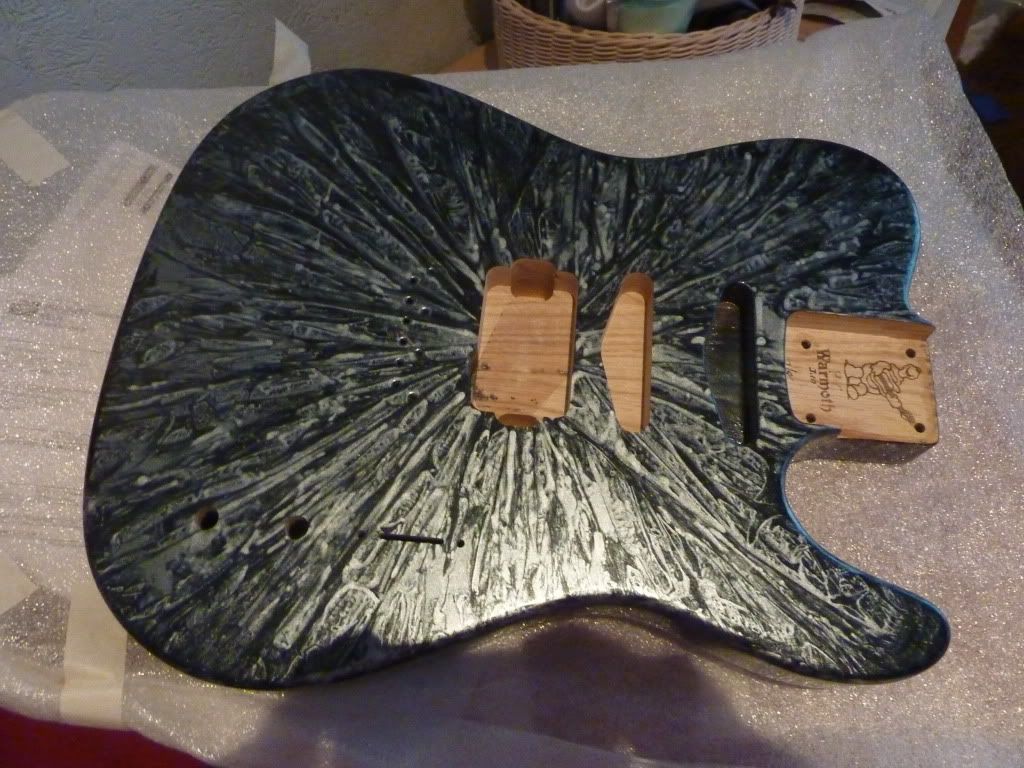

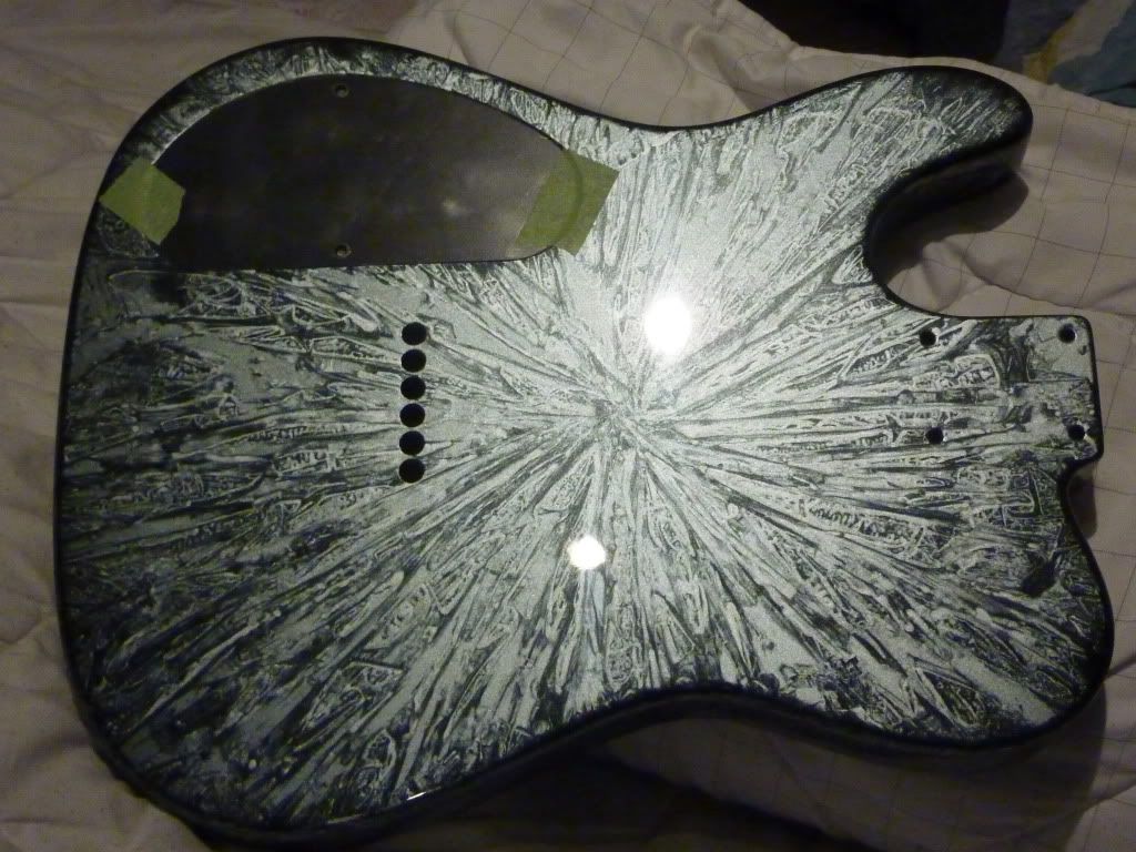

Hey everybody,
I finally did it...... I ordred a neck for my 7/8 body.  Probably everybody might not like my idea, buuuuuuuuuut
it's important that I like it, right!
This is the body I am talking about:
http://i769.photobucket.com/albums/xx332/juwel1998/P1000040.jpg
http://i769.photobucket.com/albums/xx332/juwel1998/P1000047.jpg

Not my type of Body finish .... But hey we can't be all the same.
Interesting Pup choice too  :dontknow:
