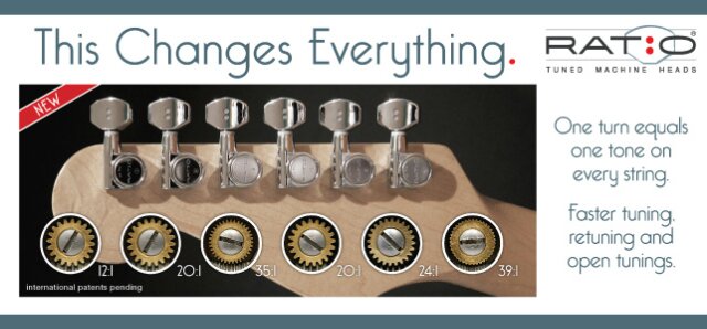

Incidentally, to illustrate the variation in the amount of stretch you need to get a half-step note change on different gauge/construction strings, check out these Graphtech tuners...
In order to get that same behavior out of a bridge in order to maintain tune, you'd have to have individual levers of varying length on each string all interconnected in such a way as to change all the string's tensions at different rates. That would likely be a difficult-to-tune and maintenance-prone mechanical nightmare.
