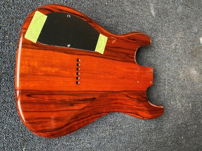

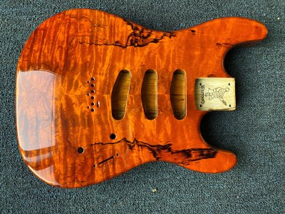

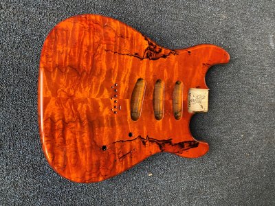

It's a combo quilted maple and spalt with a transamber finish. Body is Korina. Looks Halloweenish. The spalt looks like a spider web.
Indeed it is a great looking body. I must say personally I am not a fan of pickup rings for single coils and in this case I think they would detract from the aesthetic of the body.
