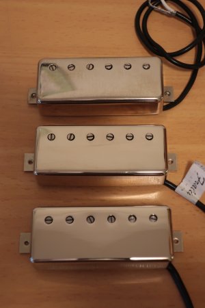

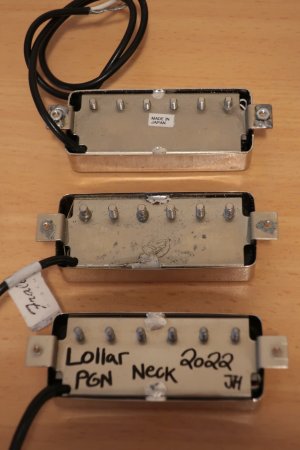

I ended up ordering a few Mini-Humbuckers:
1) Allparts PU-6550-001
2) Lindy Fralin
3) Lollar
All of these pickups seem to be the same size. Approx 28.3mm x 68.1mm (1.115" x 2.680"). However I don't think Warmoth offer a pickguard route that fits them properly.

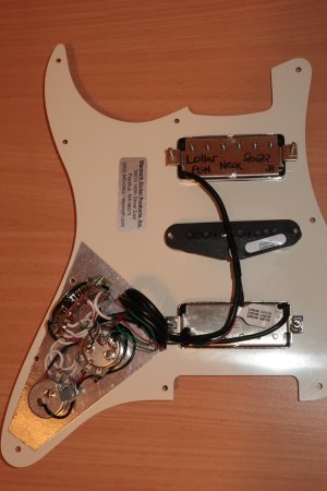

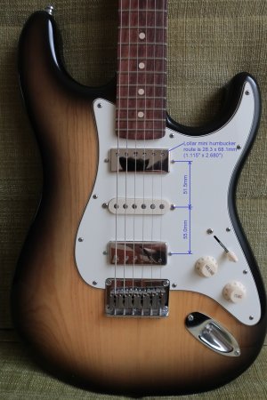

A follow up for anyone who is interested. I ordered the pickguard with only a strat middle pickup route, so it was X-S-X config from Warmoth. Then I cut my own pickup routes for the two mini humbuckers. The routes are cut to match the size of the pickup covers without any clearance. There is some taper on the sides of mini humbuckers, so when the pickup is raised it becomes a snug fit in the pickup route.
