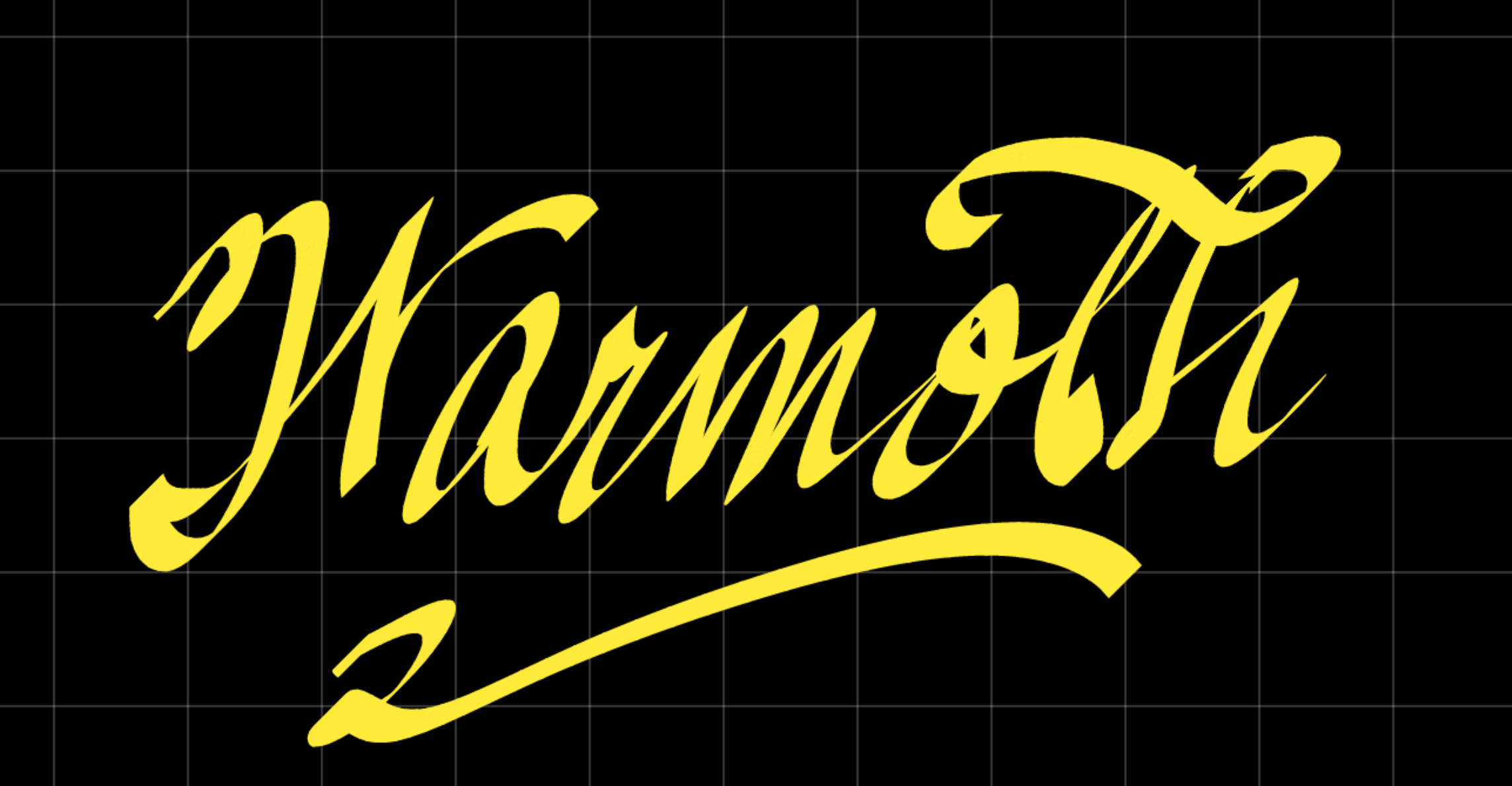

Y'all can grab this freehand job I did if you want to edit to suit.  I was just foolin' around with the stylus on my phone to see what it could do, and it turns out it can do this.
Really nice freehand!

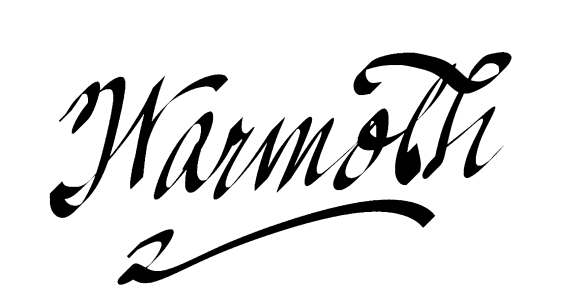

Here it is in black.  It ain't a vector graphic, but at a scale that can be used for a headstock decal, it shouldn't be too jaggy.
