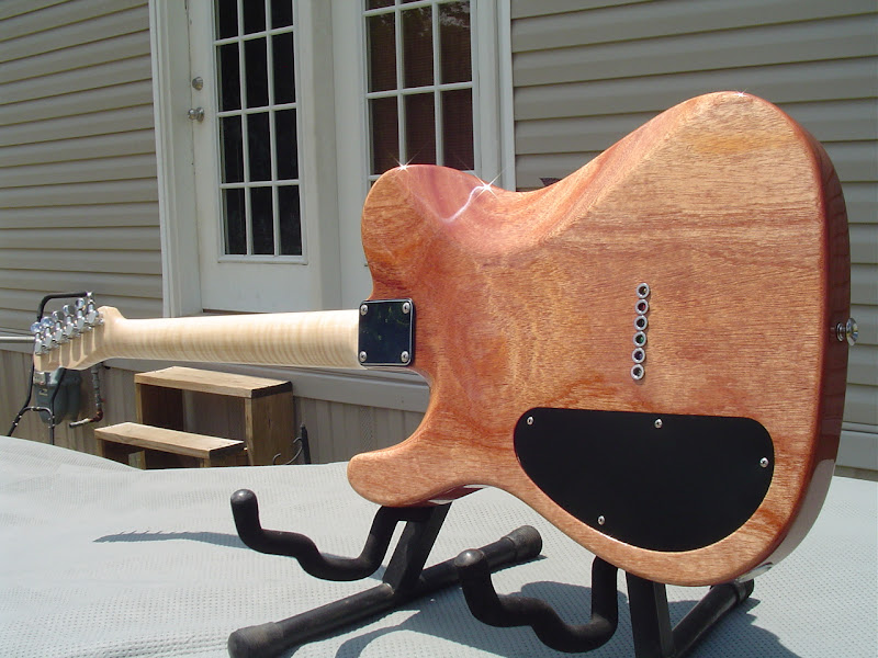

I bought my ferrels and body from Warmoth, the route is like the right, I want the left.
I agree in that the one on the left looks cleaner, but after installing them the way they look on the right, its no worries for me.  Maybe next project when I can access a drill press.
I think, I am going to do it like on the left, the logistics of it all, finding a caliper, going after a bit, finding a drill press to use, doing it right on a finished body, I think it would be better to counter sink the next one.
