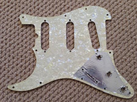

You can get rid of that static build-up/discharge by simply putting a conductive sheet on the backside of the pickguard around the controls. Most modern pickguards have that...
Doesn't need to be much - it's just there to act as a static drain. Like you say, it doesn't shield power line hum, it just gets rid of that nasty crackling noise.
Yep.  I've done this with my (un-shielded) telecasters.  With static, it just gives a ground plane for the static to discharge into (instead of into the hot lead of your pickup).  It's not really an EMI thing.  We might be splitting hairs here (for a guitar forum and all), but as it only covers one plane it's not really shielding.
