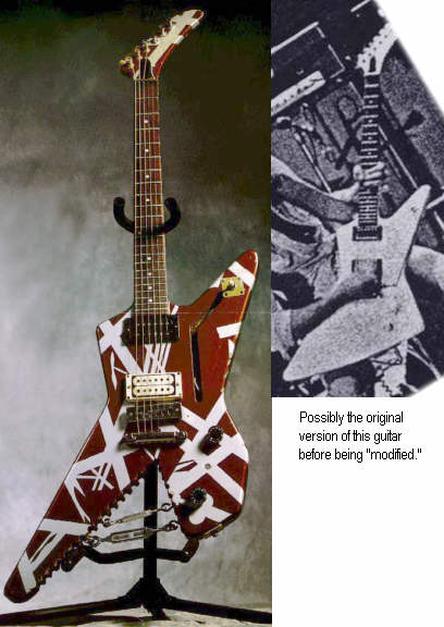

go here http://www.seymourduncan.com/forum/ and search for 598
some people claim that a 598 is similar to an Ibanez Super 70 - - which is was EVH had in his Destroyer.
I don't know, but I never worry about those kinds of things. I do know that you'd probably have to back it off of the strings a bit.
