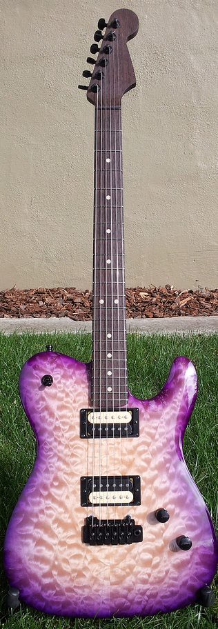

If Black Korina is similar to mahogany in tone, with a full pauferro neck... absolutely no problem.
I have a Warmoth, 1piece mahogany body with flame koa top and pauferro warmoth pro neck.
One of the most balanced guitars I have played.
However, if you then install two Gibson '57 for example, I would not doubt for a neck in Goncalo or Indian Rose.
The choice depends on many factors
