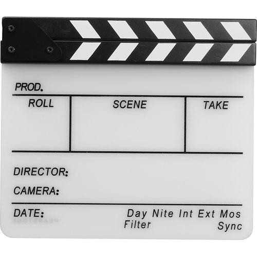

The movie folks use these things for not only that synchronizing snap, but to track takes...
Lotsa people make them - that particular unit is available here.
Ya know, I never really thought about the purpose of the clapper board before - I just figured it was for the folks on set. Makes perfect sense now.
