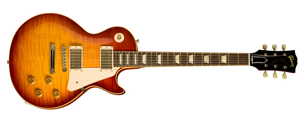

Sneak preview (the final headstock will be different):
absolutely not. I don't do inlay (like that), I don't do binding on the neck or on the body, my lacquer isn't nitro but shellac and my headstock is different, not to mention other woods! :D
